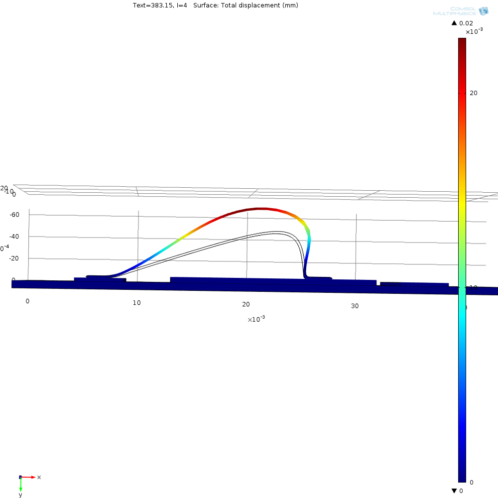

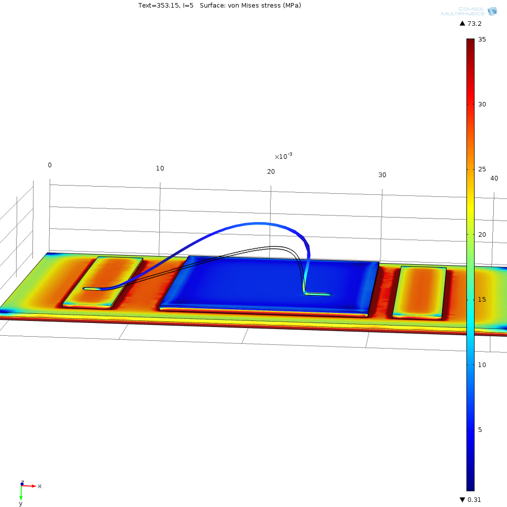

I designed an Al Bondwire on a Silicon chip with DBC. The physics were heat transfer in solids, solid mechanics and thermal expansion. I chose the copper base for the Inward heat flux with h = 10 W/m2.K
and external temp Text as 293.15 and current through the bond wire as 2A. I got some results but when i did a parametric sweep gradually increasing the Text and Current, the results remain the same, as if there is no effect of the parametric sweep. I have attached the images. If anyone can help me figure it out i would appreciate it.
Thanks in advance.
