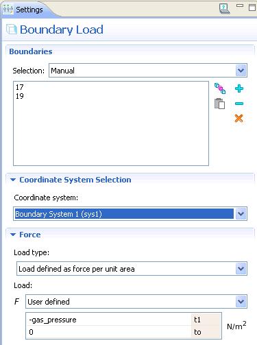

That is helpful. But I still don't see a box to USE the normal direction for a boundary load. I've attached a picture to show what I'm talking about. The only options are to apply forces in the t1 and to directions, which as you have described are actually tangential and out of the plane directions.

I looked a bit more, and it only looks like this for the 2D axially symmetric case. For both the "solid mechanics" and "thermal stress" physics modes in 2D axially symmetric the normal direction is not available.
Thoughts? I'm assuming this is a bug in the physics mode GUI? I would imagine it is supposed to look like it does for the 2D Cartesian coordinate case. Is there a way of fixing this or do I have to wait for a patch or version 4.1?

I agree 100% that a gas pressure force generally acts normal to the boundary. The problem is that when you select the 2D axially symmetric option, there is no normal vector for me to apply it on! If you look at the picture closely, you'll see that I have selected "Boundary Frame" which should allow me the option of applying forces in the normal and tangential directions (as it does if I select 2D Cartesian) but there is only the into tangential and out of the page directions. Furthermore, if you look at the equation mode, it doesn't look complete.
I think I'm either miss understanding how something or this is a bug in the COMSOL GUI.

I got a very helpful private message from one of the COMSOL staff with a workaround. I figured I'd post it in case anyone finds this thread with similar problems.
I suspect this is a bug in the 2D axisymmetric case. We are investigating it.
In the meantime, there is a workaround. In the 2D-axisymmetric case the outward-pointing normal vector has components nr and nz in the r and z directions, so you can take advantage of that to specify your load, e.g. provide components -po*nr and -po*nz for your distributed pressure of magnitude po.
Notes
1/ you can plot the (nr,nz) vector using a line arrow plot to visually check the above.
2/ if you need access to the tangential vector you can build it easily: it has components -nz and nr or nz and -nr (depending which direction you want it to point).
