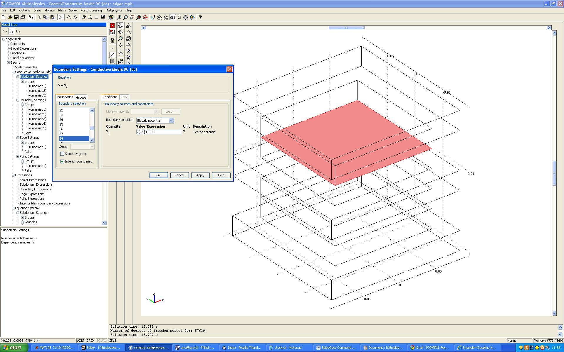

Posted: 2 decades ago 2010/10/07 5:49 GMT-4
Edgar, thanks again!
How do I enter the following BC: PlusU2 = V(MinusU2) + deltaU2.
The attached screen dump explains my question. Boundary 28 corresponds to PlusU2 and boundary 25 corresponds to MinusU2. For simplicity deltaU2=0.53.
Anders
Edgar, thanks again! How do I enter the following BC: PlusU2 = V(MinusU2) + deltaU2. The attached screen dump explains my question. Boundary 28 corresponds to PlusU2 and boundary 25 corresponds to MinusU2. For simplicity deltaU2=0.53. Anders
Posted: 2 decades ago 2010/10/07 6:01 GMT-4
Anders,
your expression would be V(x, y, z)+0.53. For (x, y, z) you use a point on your MinusU2 boundary or in the corresponding electrode subdomain. The variable V is the variable for electric potential in COMSOL 3.5a. You may need to check if it is the same in V4.0.
Let me know if it works
Edgar
Anders, your expression would be V(x, y, z)+0.53. For (x, y, z) you use a point on your MinusU2 boundary or in the corresponding electrode subdomain. The variable V is the variable for electric potential in COMSOL 3.5a. You may need to check if it is the same in V4.0. Let me know if it works Edgar
