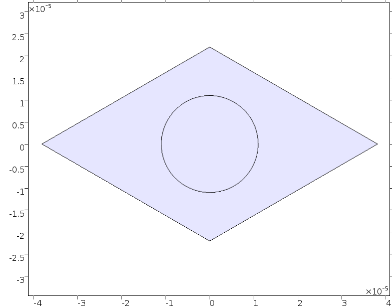

In the model, a square lattice is simulated, with lattice constants a1, a2 = a. The primitive cell is a square with the circular column in the centre. I want to simulate a triangular lattice. The cell changes into a parallelogram, and . Now, if I just want to sweep from k=0 to (M point in the Brillouin Zone), it works fine out of the box. I don't know how to proceed from here, in order to calculate the whole bandgap (Gamma -> M -> K -> Gamma). I thought I'd simply redo the initial eigenfrequency step for M point, and then move on to the k sweep. K values are defined as follows:

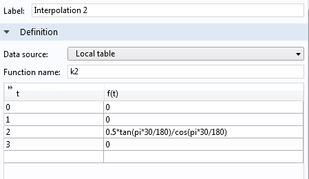

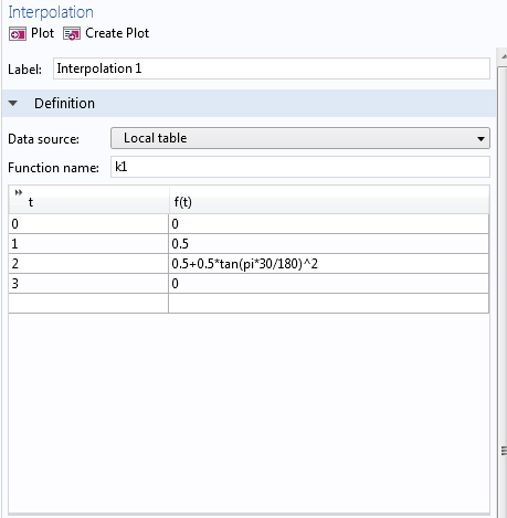

I created two interpolations in Global Definitions -> Parameters (see attached screenshots). Then I defined two variables, kx and ky, in the following way:
kx = (k1(k)*b1x+k2(k)*b2x)
ky = (k1(k)*b1y+k2(k)*b2y)
Then I set Floquet Periodic Conditions in the Physics tab and set the periodicity to kx and ky.
With this set up, you should be able to sweep k from 0 to 3, and this will correspond to the 1st Brillouin Zone of the triangular lattice.
