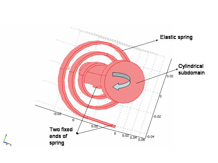

Thank u for reply.Iam not getting in correct way to do the model so
I attached my geometrical model here, that is in 3D space dimension .
The two ends of elasticspring are fixed by using holes kept on it. In middle of the spring a cylindrical subdomain is added.
Now the subdomain should rotate with the axis of rotation, and due to that there should be deformation in the spring(strain calculation due to angulardisplacement) i.e, spring winds and unwinds.
This is my problem. I didnt understand how to do this process(analysing) in Comsol.
I followed comsol multiphysics-structural mechanics-solid-stress/strain-static analysis.
I request u to send an idea how to do this process.
Hi, Thank u for reply.Iam not getting in correct way to do the model so I attached my geometrical model here, that is in 3D space dimension . The two ends of elasticspring are fixed by using holes kept on it. In middle of the spring a cylindrical subdomain is added. Now the subdomain should rotate with the axis of rotation, and due to that there should be deformation in the spring(strain calculation due to angulardisplacement) i.e, spring winds and unwinds. This is my problem. I didnt understand how to do this process(analysing) in Comsol. I followed comsol multiphysics-structural mechanics-solid-stress/strain-static analysis. I request u to send an idea how to do this process.
Posted: 2 decades ago 2010/01/28 7:01 JST
Well basically a whatchmakers spiral and the momentum wheel.
For me it applies well to the SMEUG.PDF example (the "Structural Mechanics Module, User's Guide", see page of V3.5a page 69++ or just scan for "Torsional". For me its in .../comsol35a/doc/sme/).
I agree that the explanations are not crystal clear, and I still have a unit issue I'm not happy with (at least in V3.5a, when I follow the explanations literally) but the rotation is there when I model it, even if I cannot yet get the reaction moment to match my applied moment.
One of the items is that the "cylindrical coordinate" check used to define the new user coordinate system generates a specific rotation matrix (dump your model as a M file and check the coordinate section) that does the trick, the "geom2" workplane is only there as a placeholder to access this option for the new corrdinate transform.
If you want to force and fix the rotation axis, then I would suggest to add two points along the axis on the top/bottom surface of your shaft, and enforce a displacement Rx=0 Ry=0 Rz=0 on both points. It's slightly crude as a "point constraint" but works still quite well.
Hi Well basically a whatchmakers spiral and the momentum wheel. For me it applies well to the SMEUG.PDF example (the "Structural Mechanics Module, User's Guide", see page of V3.5a page 69++ or just scan for "Torsional". For me its in .../comsol35a/doc/sme/). I agree that the explanations are not crystal clear, and I still have a unit issue I'm not happy with (at least in V3.5a, when I follow the explanations literally) but the rotation is there when I model it, even if I cannot yet get the reaction moment to match my applied moment. One of the items is that the "cylindrical coordinate" check used to define the new user coordinate system generates a specific rotation matrix (dump your model as a M file and check the coordinate section) that does the trick, the "geom2" workplane is only there as a placeholder to access this option for the new corrdinate transform. If you want to force and fix the rotation axis, then I would suggest to add two points along the axis on the top/bottom surface of your shaft, and enforce a displacement Rx=0 Ry=0 Rz=0 on both points. It's slightly crude as a "point constraint" but works still quite well. Good luck Ivar

thu = 0.5*(wy-vz)
thv = 0.5*(uz-wx)
thw = 0.5*(vx-uy)
It's the antisymmetric, or curl part of the general displacement formulation shown hereafter in 2D:
du = (du/dx)*dx + 1/2*(du/dy + dv/dx)*dy + 1/2*(du/dy - dv/dx)*dy
or
du = ex*dx+1/2*exy*dy-thz*dy
You can recognise the normal and shear strain and the "rigid body" rotation thz
I hope this will help you on your way
