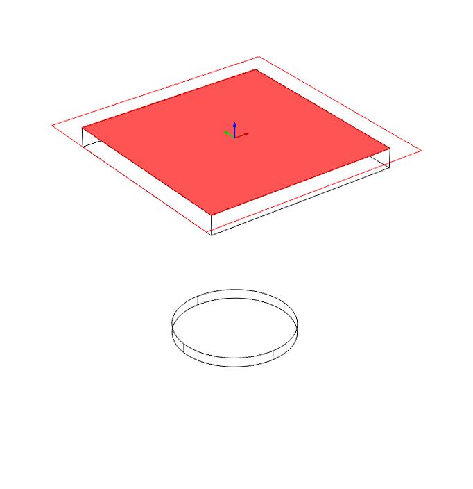

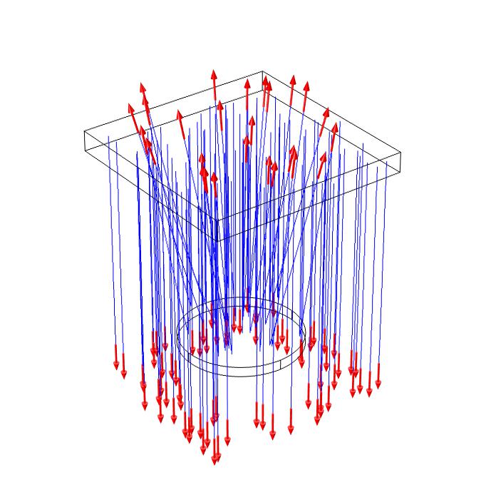

I'm trying to measure the phase of a bundle of rays that are reflected from an aspherical surface.
File 1 attached is the ray tracing and the red plane in file 2 is the surface on which I want to know the phase of the rays.
I can see that there is an option but every time I try to plot the phase on a curtain plane I recieve an error message:
Cannot evaluate expression.
Undefined variable.
- Variable: comp1.gop.Psi
- Geometry: geom1
- Domain: 3
- Expression: comp1.gop.Psi
- Plot: surf1 (Surface)
The 3rd domain is the aspherical surface that reflects the light (the circle in the files attached).

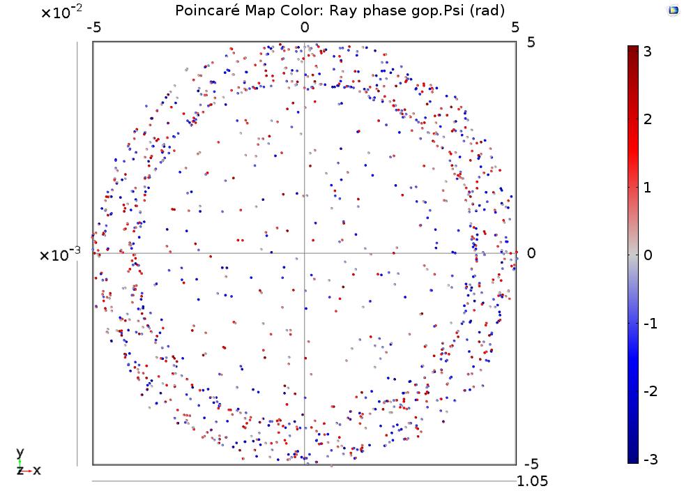

Hi Andrey, the phase is a property of the rays, rather then the geometry, so when you try to evaluate it on a geometric entity, it fails.
The solution is to define a cut plane where you want to evaluate the phase, then use the Poincare Map plot type to create a spot map of the phase. The Poincare Map plot type allows you to plot quantities defined only on the rays at the intersection point between the rays and a geometric entity. You can refer to the attached (V5.2) model to see how to do this.

In my simulation I defined a cut plane and used the "Accumulator" node I understood that I should use to transfer physical information from rays to the domains they pass through. But it didn't work since I do not know how to define it correctly. Can you please help with that method?
I tried the poincare map and it works well when I'm using the color expression and plot gop.Psi, but the results are a little bit weird, I expect a symmetrical phase map and it is not symmetrical (see attached file).
Maybe, has Ivar said, I need a reference ray. How can I define a reference ray that will intersect with the middle of my "cut plane"?
