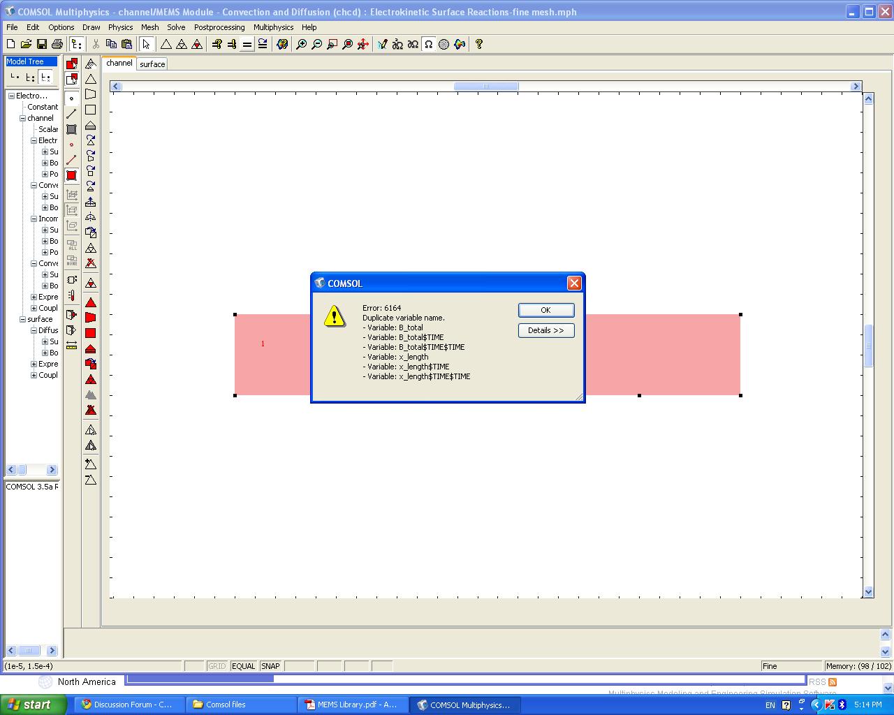

I have a problem when I run MEMS library > Microfluidics > AC Electrokinetically Enhanced Surface Reactions" Model Library.
I get an error 6164.
It says duplicate variable for:
c_surf
c_surf$time
B_total
B_total$time
B_total$time$time
x_length
x_length$time
x_length$time$time
SCREENSHOT IS ATTACHED.
Please help.
Thanks.
Felix

for me it looks like you have two similar physics/applications with the same name, or something that have duplicated the internal names
Hi for me it looks like you have two similar physics/applications with the same name, or something that have duplicated the internal names -- Good luck Ivar

Hi Ivar,
I have merely followed exactly step-by-step from the Model Library example.
Are you saying that the Model Library guide example is erroneous?
Thanks.
Felix.

that can happen, but I doubt it, mostly it's that in copying we have overlooked a simple point, and today with the rapid evolatution from 3.5 to 4.0, .a, .1 ... things are changing so quickly that such errors are more frequent (and frustrating I'm with you there ;)
My suggestion, and way around, is to start again from scratch, and try to solve intermediate results, one physics at a time, to be sure I get all points and then couple them
