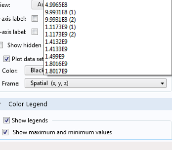

4- regarding the TE and TM modes, after simulating and obtaining the eigen frequencies I got all the frequencies that could be existed in the wave guide without differentiating between to which mode it belongs and i got some other doubled frequencies just written (1), (2) after each frequency but actually I didn't understand why it's like that. I have attached you an image with that.

4. The solver can find degenerate modes (more than one mode corresponding to an eigenvalue). You probably have some symmetries in your model that encourage this to occur. Note also that the solver can find "modes" which are not actually distinct modes at all (or even genuinely legitimate modes) but which had numerical properties that fell within a tolerance level that seemed to imply, to the solver, that they were modes. One can typically see the difference by looking at the field plots, if one is familiar with these things. The computer program, however, does not review its results in that manner, nor does it possess any artificial intelligence; it doesn't really know what results to discard and what to keep, if they meet the numerical criteria in its programming.
