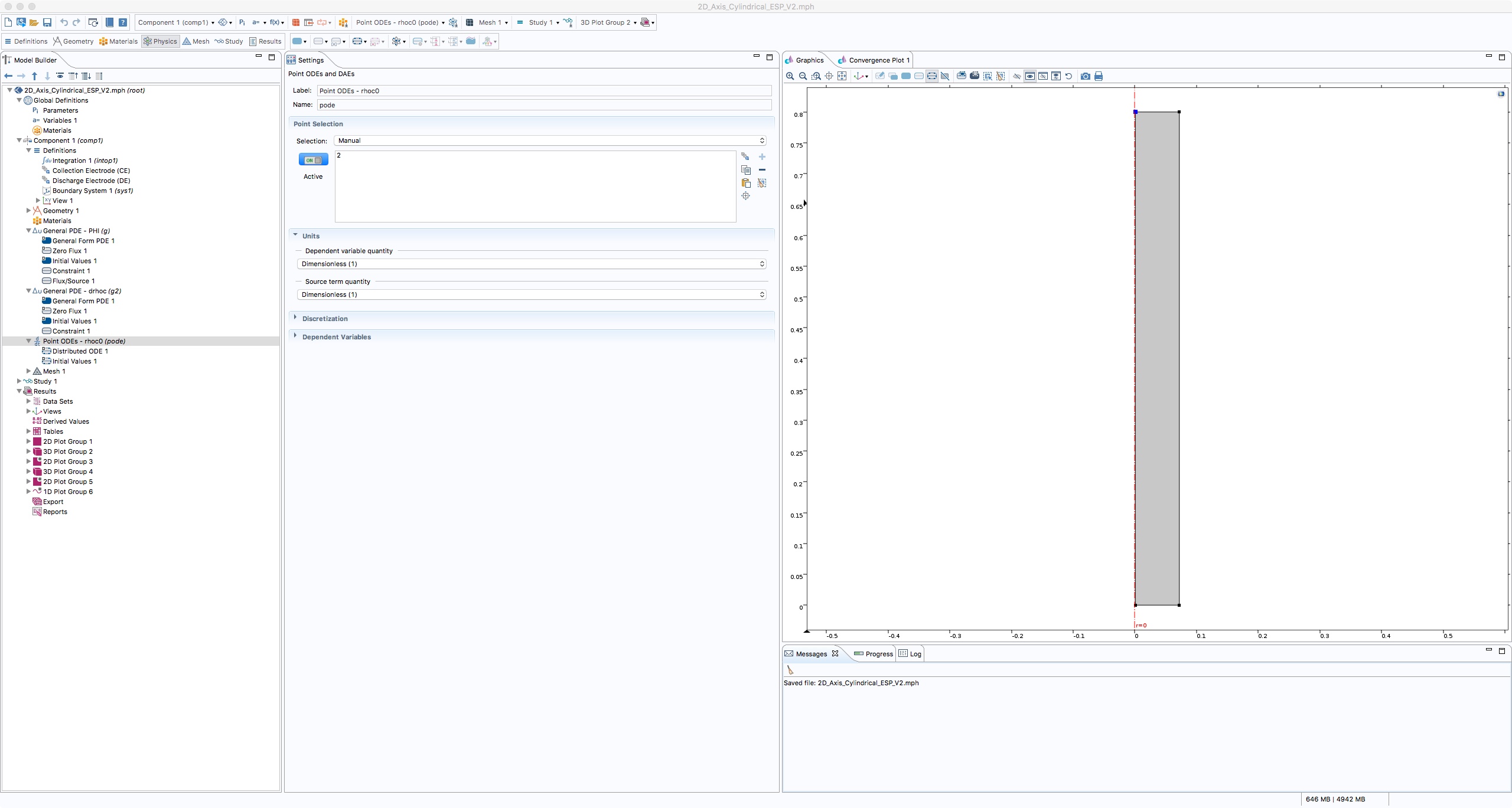

I have another question about the integral constrain using the point ODE. I am solving a 2D Axisymmetric ESP (see attachment). Instead of using a fixed point to constrain the electric potential to V0 at the discharge electrode, is it possible to move the point ODE along the z-axis during each iteration step to obtain a 2D distribution of the electric potential?
Thanks again.

Posted: 9 years ago 2016/12/02 12:12 GMT-5
Hello Eric,
What is possible is to have a fixed potential at the electrode together with a non constant charge density over the electrode. I don't think the location of the point matters. I might not fully understand your request though. We can help you regarding these questions through the technical support. I encourage you to contact support@comsol.com regarding this.
