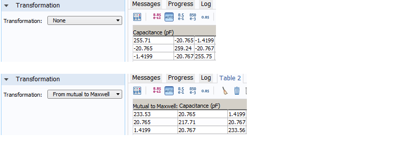

Posted: 8 years ago 2017/06/08 15:21 JST
Updated: 8 years ago 2017/06/10 15:24 JST
Sergei,
Sure , in your file, you have plotted the first one under Transformation: None
the second one is under Transformation: Maxwell to mutual
Please try the following option under Transformation : mutual to Maxwell, you will get exactly the same answer for, may be that is an error or something I guess.
Transformation: Maxwell to mutual and mutual to Maxwell.
Sergei, Sure , in your file, you have plotted the first one under Transformation: None the second one is under Transformation: Maxwell to mutual Please try the following option under Transformation : mutual to Maxwell, you will get exactly the same answer for, may be that is an error or something I guess. Transformation: Maxwell to mutual and mutual to Maxwell.
