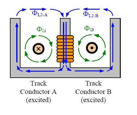

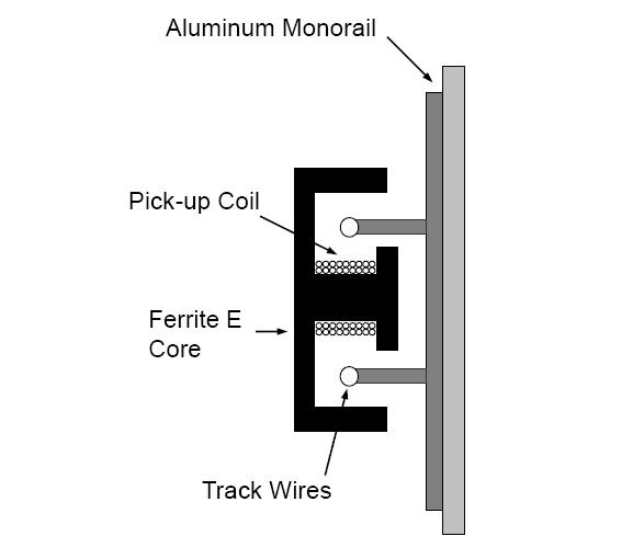

I have created a 2D-model (with some help from Comsol support) of an Inductive Power Transfer system wich consists of two straight wires (named "track" in attached models) generating a varying magnetic field and a secondary coil wich is wound around a ferrite core (named "coil" in attached models). The track carrying a current generates according to faraday's law a voltage in the secondary coil.

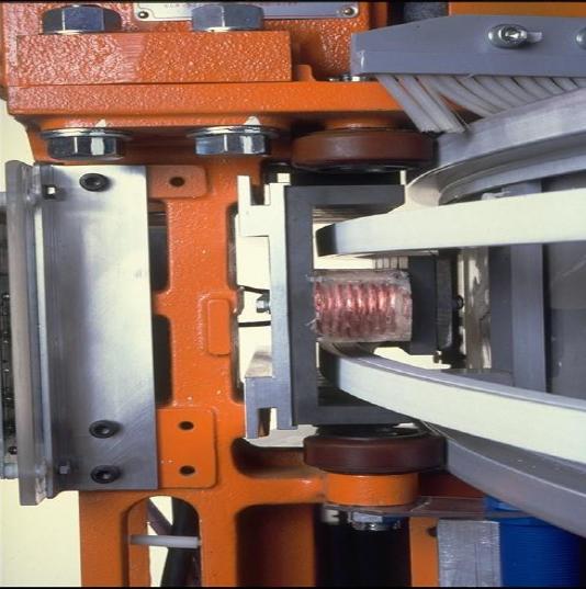

To make a better understanding of the system that I'm trying to simulate I have attached some illustrations that I found on the internet.
