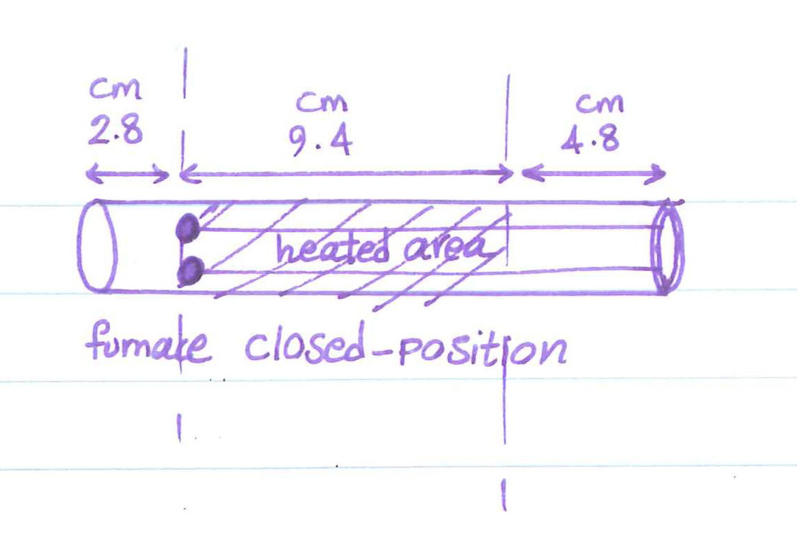

I model a furnace. It is a tube. A part of this tube's wall is the heated area of the furnace. The temperature of inside of the tube reads 900 C, so that the heat transfer mechanism from tube's internal wall to all components inside the tube (two beams and cups) is radiation.

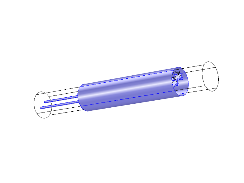

I attached my geometry for better understanding here.

I have only a tube which you can see in both pictures, and a part of the wall of this tube is getting hot and radiates the heat to the internal components (two beams and cups at the end of them).
Now I want to introduce this radiation from this part of tube wall to internal tube. This is while inside the tube I have laminar air flow+two beams (from Alumina)+two cups at the end of the beams (from Alumina)+a carbon sample inside one of the cups. (I attach my model to see it better). So that each of these parts (air,beams,cups, carbon) will adsorb the radiated heat from the wall according to its own view factor compare to wall material of construction.
But how to add material of the construction to wall?? This is the challenge for me!
Shall I make a solid shell? shal I make a surface cylinder? shall I not make any wall (cylinder) but work with my work place wich is the same position as the tube wall?
I attach you two works, one I made a surface cylinder, another I made a solid shell.
