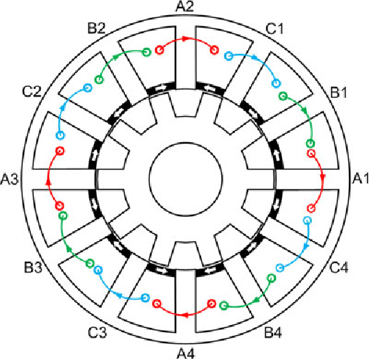

Hello, I'm modeling a Permanent Magnet Machine, and I want to change the orientation of the magnets to have the same orientation as in the figure that is attached, anyone could help me?
Regards, João Oliveira

The magnetization can be done using the cylindrical co-ordinate system as done in this Magnetic Gear model. See the blog post and associated model files. https://www.comsol.com/blogs/modeling-magnetic-gears-in-comsol-multiphysics/
Best Regards, Nirmal
Hi, The magnetization can be done using the cylindrical co-ordinate system as done in this Magnetic Gear model. See the blog post and associated model files. https://www.comsol.com/blogs/modeling-magnetic-gears-in-comsol-multiphysics/ Best Regards, Nirmal
Posted: 7 years ago 2018/05/11 17:48 JST
Hi Nirmal, Thanks for your reply, now I got it.
Best regards João Oliveira
