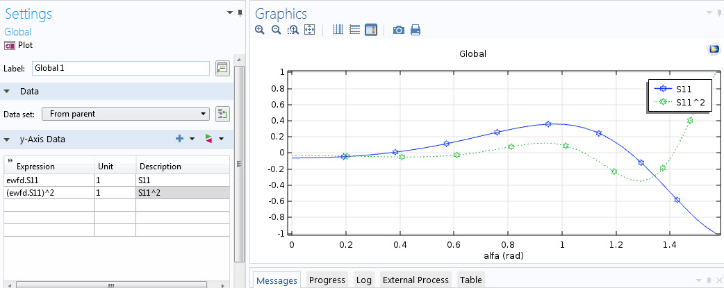

Hello my freinds, (^2) can change negetive sign to positive but why we should use ”abs” before for example; abs(ewfd.s11)^2 to calculate norm of S11?

Dear Nichal, ewfd.S11 is scalar matrix. it can be real ,complex, positive or negetive but here, this matrix is real and mixed of positive and negetive numbers. I dont know why (ewfd.S11)^2 has negetive number ?

Thank you for your quick reply. S11 is a matrix that have 2 column and many rows(for example 100) and S11(:,1)(means whole of rows and column1) are same (assume they are frequency) for all calculation. so, How we can use matrix multiply if we have S11 with one column that can be changed.

I guess there is some confusion about the S-Matrix. The dimensions of the S-Matrix depends on the number of ports the system has. S11 is one scalar element of the S-Matrix characterizing reflections from port 1. It is in general a complex number and that is why S11^2 can be negative.
Cheers Edgar
