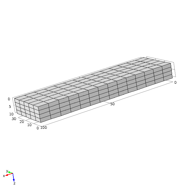

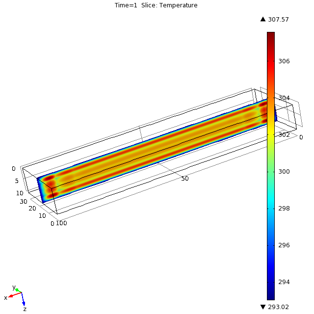

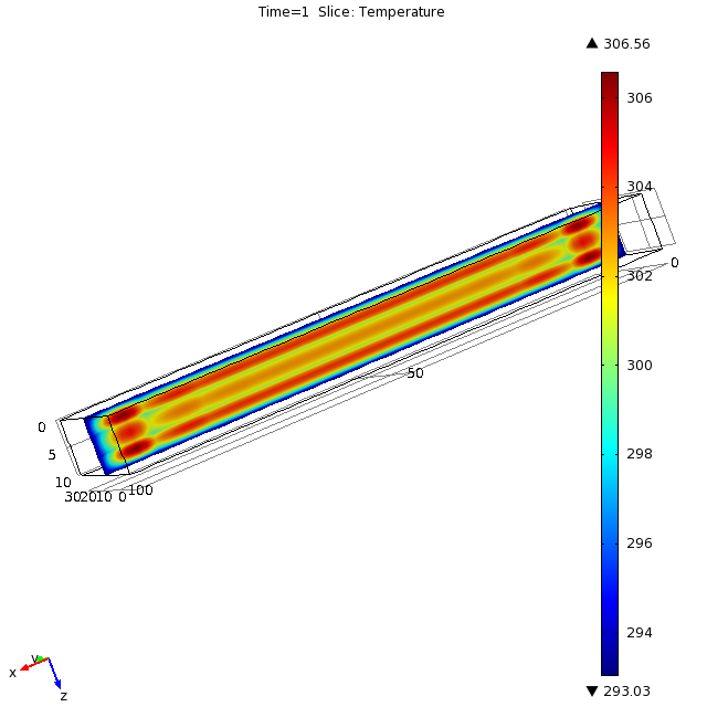

I use Comsol to model a coupling problem thermo-mechanics. However, when I tested a simple problem of heat transfer in 3D (with a internal heat source and adiabatic case), the results received are not good. Because they depend on the mesh.
When I tested with 3 elements in the height, there were 3 layers of temperature distribution in this part. Or, 4 elements in the height, there were also 4 layers of temperature.
You can see these results accompanied in this message.

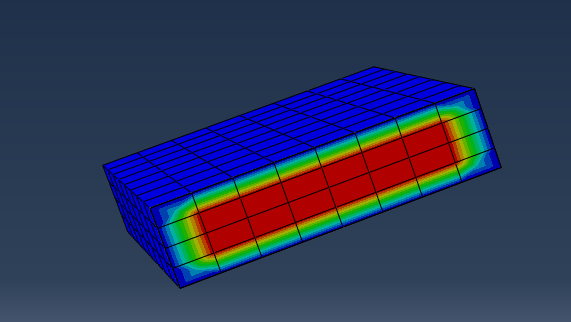

I try this test in Abaqus. The temperature field does not depend on the mesh. I'll give you this result.

The result of temperature in abaqus is continuous. But in the Comsol, the distribution of temperature is depend on layers of mesh as in the picture.

I had a quick look at your model file and it looks like given the values of the material properties and time span you selected you have extremely thin thermal boundary layers that simply cannot be resolved by these meshes. You'd need a mesh with much finer elements along the boundaries to arrive at a solution that's reasonably close to the analytical solution.
