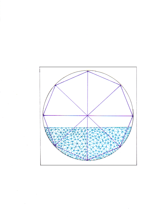

We want to model a front load washer partially filled with water as shown in the attached Cross Section 3 screen shot.

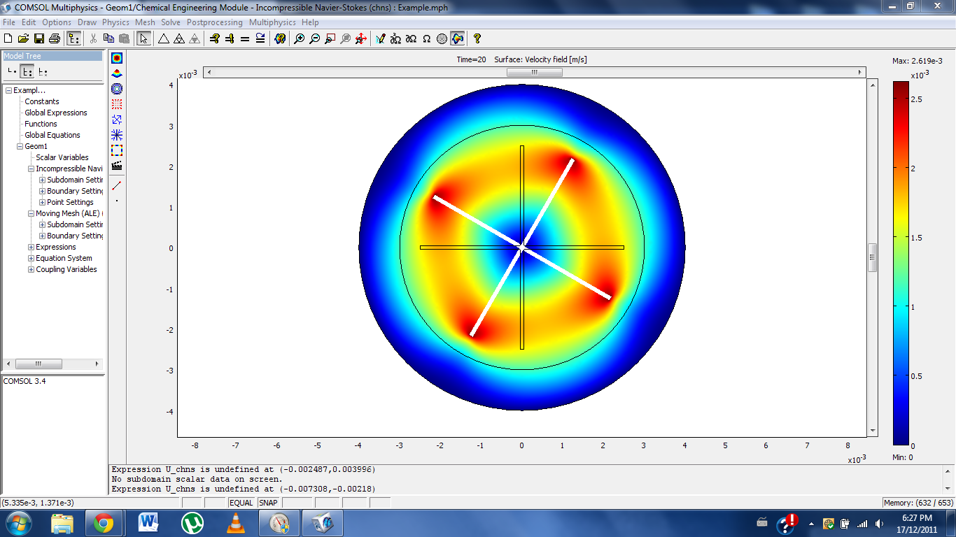

We formed our base model off of the schematic pump 1 example in the model library of COMSOL 3.4 (see attached mixer model screen shot). The problem with this model is that the mixer is entirely full of water, and the model we are trying to create (the front load washer) is only partially full of water.
Is it possible to model a partially full mixer?

I would propose to llok in the direction aof an ALE section formthe partially filled water part (but do you need to model the air above ?) or perhaps try a level set method, check the doc, I must admit it's not something I have tried, but probably there are other out there with bettrer or more precise ideas (check also the sloshing tank model in the model library)

Returning to the drawing board we looked at the Schematic Pump #2 example in the Chemical Engineering Module. This is simply exactly what we want to model but without and inlets and outlets and with the pump to be half full. However, I could not find any examples of mixing two fluids or water and air, hence, we are still stumped.

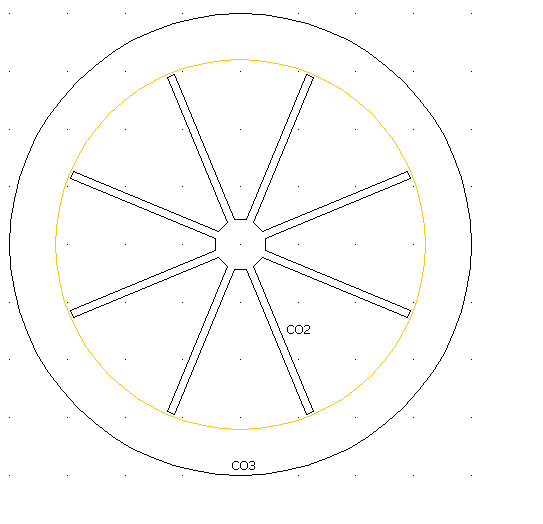

On a side note we tried to run the Schematic Pump #2 by just changing the impeller geometry and the model would not converge. The same boundary conditions are applied and the outer geometry remains relatively the same (the inlet and outlet is removed ... which converged with the original impeller) it is just the impeller has more blades and is larger as shown in the picture attached. Does geometry have that much of an effect on the model converging?
