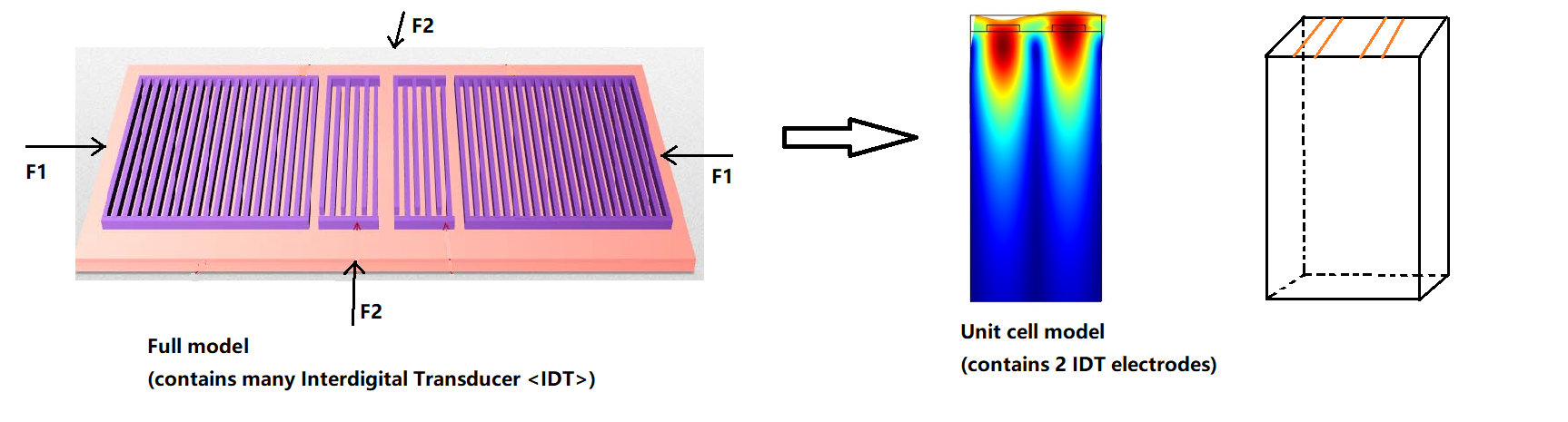

In the attached image, a surface acosutic wave (SAW) sensor is shown, wherein four pressure forces (N/m) are applied on the lateral sides of the substrate. Due to the size of the full model, a unit cell model is adopted instead, which is a periodic struture including two IDT electrodes. In the simulation, I know that two Periodic boundary conditions should be assigned to the front/back, and left/right sides, respectively. My question is: can I add the Pressure on the lateral sides as shown in the full model? If can't, is there any solution?

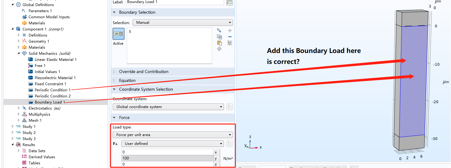

Hi, Dave. Yes, you are right. But I am not sure this is correct or not. On the lateral surfaces, not only the Periodic Condition will be given but also the Boundary Load.
>Look into doing an Eigenfrequency, Prestressed Analysis. Hi, Dave. Yes, you are right. But I am not sure this is correct or not. On the lateral surfaces, not only the Periodic Condition will be given but also the Boundary Load.
