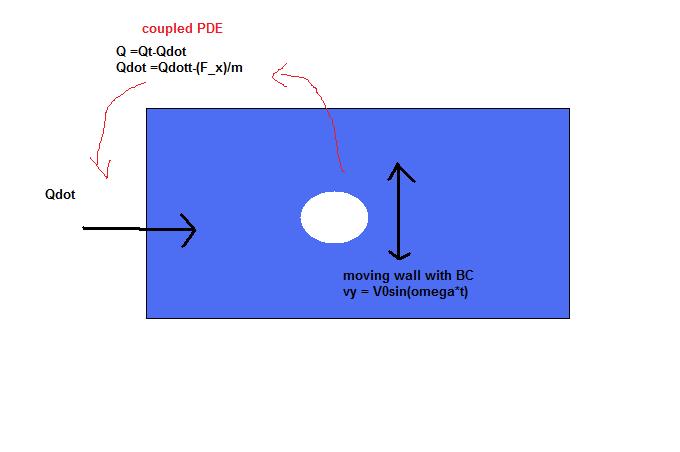

I am doing a simple 2d spf flow past circular cylinder. I see my results (particularly reacf(v)) highly depending on position of inlet. which is correct distant at which inlet should be placed before a circular wall?.

actually my flow is calculated due to oscillating cylinder using coupled differential equation as in the 'falling sand' tutorial (plz see the attached figure). The inlet velocity isQdot, which is calculated using reacf(v) from the body-fitted frame. My results varies 2e3 times the theoretical results. But ironically my results changes a lot depending on the position of inlet. I have no clue.

Dear Verheggen, Thanks for your reply. I understand that. actually my flow is calculated due to oscillating cylinder using coupled differential equation as in the 'falling sand' tutorial (plz see the attached figure). The inlet velocity isQdot, which is calculated using reacf(v) from the body-fitted frame. My results varies 2e3 times the theoretical results. But ironically my results changes a lot depending on the position of inlet. I have no clue. thanks again for your thoughts. Siva
