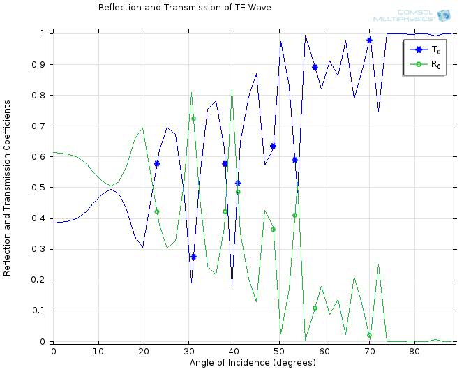

Posted: 1 decade ago 2012/05/16 4:18 JST
Hello Alexander,
I upload one pic on my calculation. It polted the relation btw the R/T coefficients with incident angle. I attempeted to change the size of the mesh and these oscillation still exists.
It is the oscillation that caused me to use the PML+scattering field to calculate the R/T coefficients of the grating, not "Port".

Posted: 1 decade ago 2012/05/17 3:50 JST
Hello Alexander,
Are you sure they are coming from ports? Way to check it is to shift your port by quarter-wavelength further away from the grating and see if the results changes. If that's the case, then I suspect that you didn't setup ports correctly. By looking at your grating, ports should work just fine.
[QUOTE] Hello Alexander, I upload one pic on my calculation. It polted the relation btw the R/T coefficients with incident angle. I attempeted to change the size of the mesh and these oscillation still exists. It is the oscillation that caused me to use the PML+scattering field to calculate the R/T coefficients of the grating, not "Port". [/QUOTE] Are you sure they are coming from ports? Way to check it is to shift your port by quarter-wavelength further away from the grating and see if the results changes. If that's the case, then I suspect that you didn't setup ports correctly. By looking at your grating, ports should work just fine.
Posted: 1 decade ago 2012/05/17 4:57 JST
Thanks for your suggestions. I will check the port. In fact, "Port" method is simpler than PML and no need to calcualte the outflow power.
Hongtao
