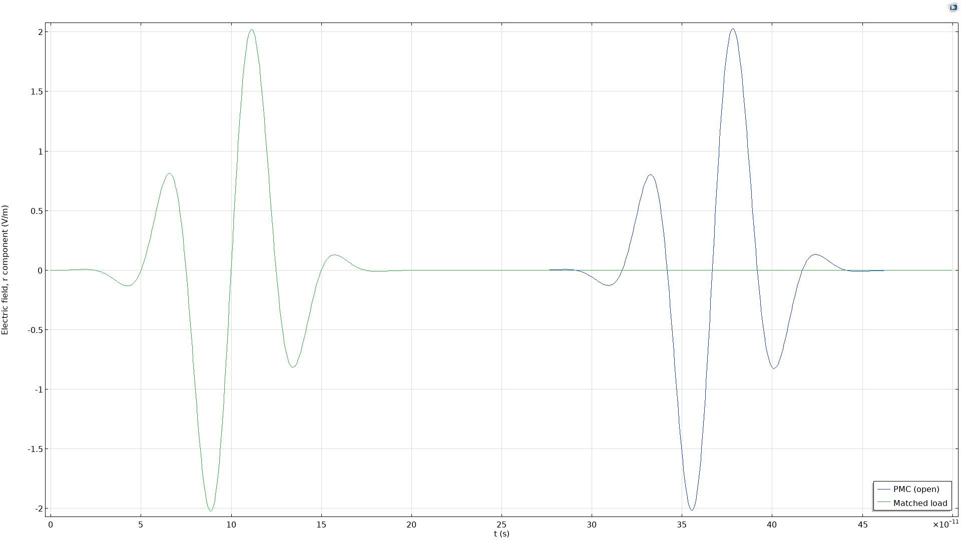

I'm using the coaxial_cable_transient verification example from the RF module. I noticed that by default the calclulated fields have an immense amplitude of 1E13 V/m (I guess by default this gives the 50ps gaussian pulse a unit area). That seemed awkward, and I prefer to have field amplitude normalized to 1(V/m) so I multiplied the input pulse by a 1E-13 scalar to give it a unit amplitude. That's all I did. I put a 1E-13* in front of the V0(t) in the Voltage parameter for Lumped Port 1 to try to get things nearer to 1 V/m.
Much to my surprise, this seems to totally break the simulation. The wave pulse gets about halfway into the coax and then disintegrates. The solver terminates very quickly. No error or warning is given, but the simulation is clearly wrong. I tried other scale factors. Everything seems to work down to 1E-8, but starts to go to hell at around 1E-9.
Is there some underflow bug in Comsol? Or is this some well known scaling limitation? I'm running Comsol 5.1. Please don't lecture me about upgrading. Why would a simple scale factor on the fields break things in any version? I just want to know if this bug is really there, or if I'm dumb for thinking I can normalize the input pulse to 1 V/m in this verification example. Maybe I need to click on some arcane solver option to get past this? Thanks if you can help.
