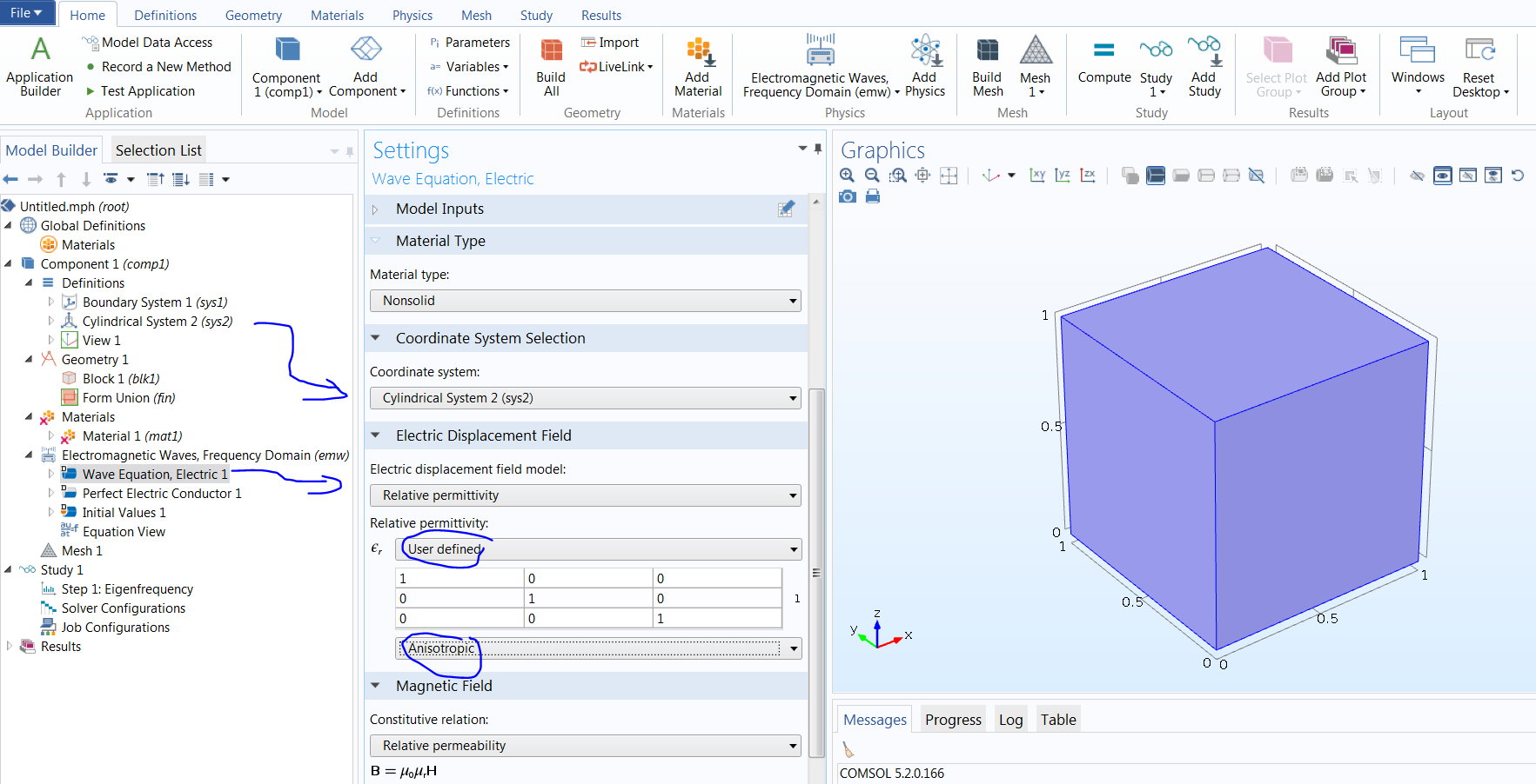

there are a few ways:
a) you define your materials properties (nodes) accordingly
b) you define it in the Physics sub node
Normally anisotropy is defined with respect to a given coordinate system that might not be the default Cartesian one of your model, therefore often you must also define a Coordinate system and refer to the correct coordinates, which might by something like sys2.r, sys2.phi ...
As I find it very easy to get the anisotropic coordinates wrong, I do always plot the new coordinate system and the tensor values in a specific dedicated plot, for that you must set up your Solver, do an "Get Initial Values" and make a coordinate plot + a plot of your tensor values in the desired coordinate system
Hi there are a few ways: a) you define your materials properties (nodes) accordingly b) you define it in the Physics sub node Normally anisotropy is defined with respect to a given coordinate system that might not be the default Cartesian one of your model, therefore often you must also define a Coordinate system and refer to the correct coordinates, which might by something like sys2.r, sys2.phi ... As I find it very easy to get the anisotropic coordinates wrong, I do always plot the new coordinate system and the tensor values in a specific dedicated plot, for that you must set up your Solver, do an "Get Initial Values" and make a coordinate plot + a plot of your tensor values in the desired coordinate system -- Good luck Ivar

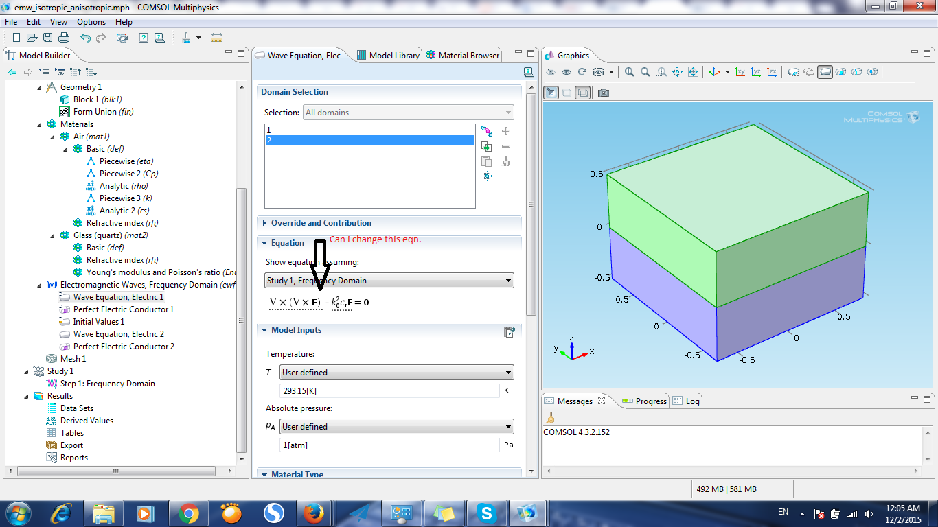

Thanks Ivar for your message. Please see the attached file, you may come to know what exactly I want to do. It will be better if you show me an example on how to change the coordinate system and then define tensors. I have seen last file from you and it helps me a lot.
I want to study the behavior of electromagnetic wave at the interface of two different media, one is isotropic and the other is anisotropic. Please do more discussion with me.
I will really appreciate your cooperation. My email is waqasmahmoodqau@gmail.com
Please illustrate me in detail.
Waqas.
Thanks Ivar for your message. Please see the attached file, you may come to know what exactly I want to do. It will be better if you show me an example on how to change the coordinate system and then define tensors. I have seen last file from you and it helps me a lot. I want to study the behavior of electromagnetic wave at the interface of two different media, one is isotropic and the other is anisotropic. Please do more discussion with me. I will really appreciate your cooperation. My email is waqasmahmoodqau@gmail.com Please illustrate me in detail. Regards, Waqas.
Posted: 9 years ago 2015/12/02 5:33 JST
You cannot change the equation in the equation window there, but you may adapt the underlying equation used by COMSOL, however then you really must understand all the details under the hood! To start you need to turn "on" the "Equation view" in the preferences, and in the same time the other Advanced tabs too. But it's tricky, as there are many relationships, depending how you define your physics.
The cleanest way is to use the global mathematical entry, instead of the standard physics, and rewrite your physics your way. There is also the Model Builder, but its rather heavy if you do not have got a good training (I have tried a few times but not succeeded to become an expert in that interesting part of COMSOL, yet)
