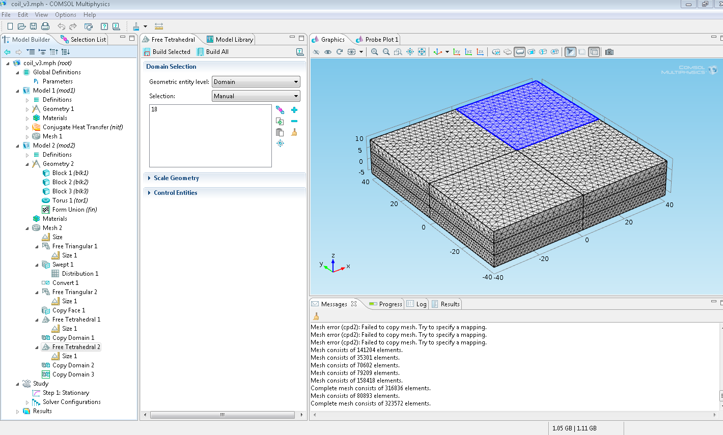

Based on your advice, I tried to setup a 3D model. For some reason I am now getting a weird meshing error. It looks like the Mesh engine cannot handle the curvature of the 'wire'. I tried both a helix structure and a torus, but I get the same error with both. I have attached both my model files.
Do you have any advice? I have never seen such an error before. I really appreciate your help.

meshing a helix is delicate, I have never really seen that work nicely before also for other software than COMSOL, its' not so much making a single helix mesh, but as for your case there are several embedded helix's+ the air around that gets a weird mesh or as you see no full mesh at all.
One way around is to make 3 loops (torus's and not an helix) and simulate that, you can then even cut up into 1/8 by symmetry (but that would not be compatible with a Y gravity vector, hence only 1/4). Or what I often do, cut into 1/4 slices as then you do not have full torus topologies and the mesh is often easier made, not to say you can use mesh mirror commands
furthermore for your case with joule heating at term for your coils you should ideally add some straight cables going all the way out to the boundary, and loop the current around in the outer air boundary to preserve current conservation, but that is another story

It looks like taking a torus and splitting it into 4 parts helps in terms of meshing. Just to make things simple I am looking at one loop of wire. Also, I am not trying to model Joule heating. I already know the power dissipated, so I am just interested in strictly a thermal problem.
For some reason, now I am getting a convergence issue. I get the error:
Failed to find a solution.
Very ill-conditioned preconditioner.
The relative residual is more than 1000 times larger than the relative tolerance.
Returned solution is not converged.
I wonder if the issue is with my boundary conditions. Right now all the boundaries on my box (i.e. surrounding air) is Open Boundary. Do you think this is a good idea? I tried to make some of the Thermal insulation, but that didn't really help.
I have attached my model file for your convenience. Sorry to keep bothering you, but it's easy to get frustrated. Your advice is much appreciated!

first of all there is a much easier way to split your volume in "Union" mode. You simply add a layer in your block on left and front side of half the total width length i.e. 40 here
Then you draw your full torus (the two you want)
and that is it
When you enter into the material mode, COMSOL unites the objects and split them up accordingly (this does not always work like that for helixes, that is also an issue ;)
Anyhow its does not seem to be enough the ration of your torus diameter to the large block diameter is such that the mesher has issues to stitch the mesh together, you need to use a very fine mesh, hence many elements, oyu migt ned to cut your air volume into toe in the thickness too, to help the mesher

I did what you recommended (splitting the air into 3 parts and increase mesh density) but my model still does not converge.
I looked at the screen capture you provided and it looks like your mesh is much more sophisticated than mine. Am I correct? How did you go about making your mesh? Or is the standard meshing that I used fine? I have attached my model again.

Any other thoughts on why model is having an issue converging? I have attached it again. I feel like it's either a mesh issue and/or some boundary condition.
Essentially, I want to see the temperature around a wire (with insulation) given a certain power dissipation; the main physics I am interested in is natural convection. I only have a simply model setup in the attached file. However, my end goal is to have a 30-40 turns and see how the spacing between the wires impacts the temperature.
I have setup this problem using a 2D-axi symmetric setup. Unfortunately, I am limited by the direction I can use for gravity with respect to the orientation of the coils. Thus, I have to go to a 3D model.
I would appreciate any thoughts anyone might have!
