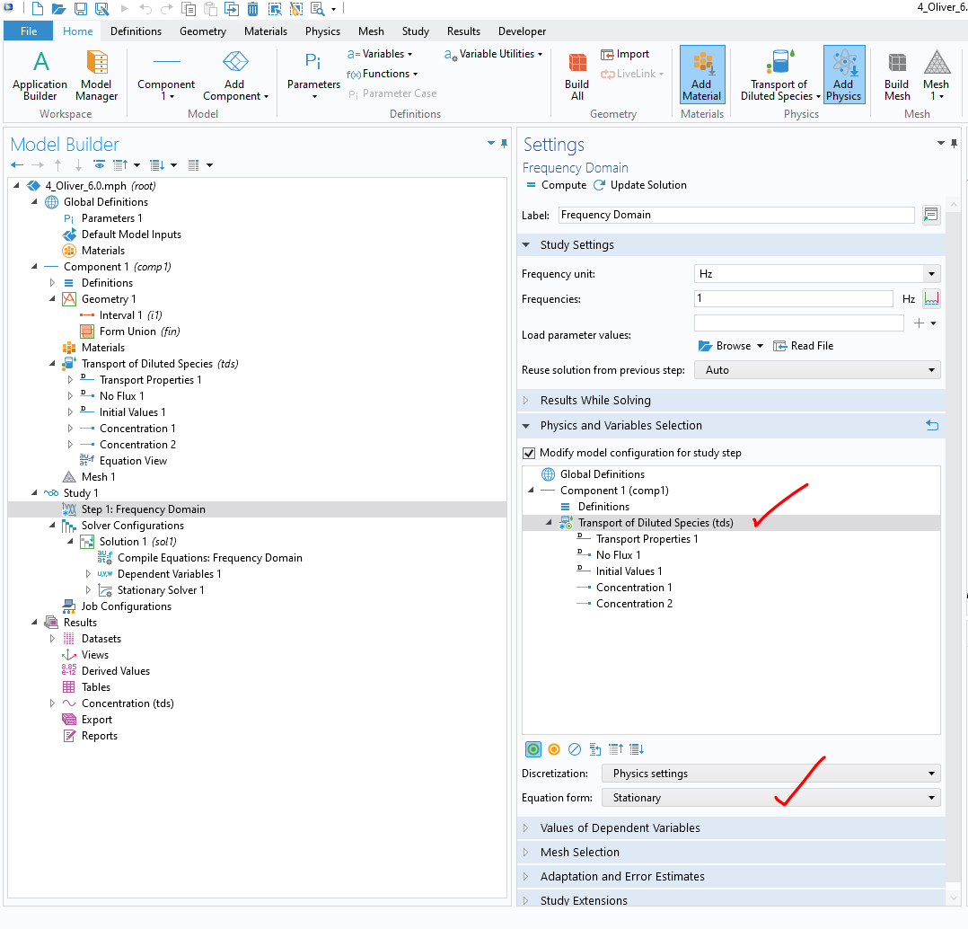

At least in version 6.0 and 6.1, I think there can be a way to use the Stationary Solver of the Frequency Domain Study step to solve the transport of diluted species physics. Have a look at the attached model and screenshot, where the model configuration for the study step has been modified in the study settings.
If not, then probably your work around is the best idea. You could use pressure acoustics with acoustic structure interaction for the built in coupling, and then manually add the transport PDE from the mathematics branch if that would be easier to setup.
Mark
Hi Oliver, At least in version 6.0 and 6.1, I think there can be a way to use the Stationary Solver of the Frequency Domain Study step to solve the transport of diluted species physics. Have a look at the attached model and screenshot, where the model configuration for the study step has been modified in the study settings. If not, then probably your work around is the best idea. You could use pressure acoustics with acoustic structure interaction for the built in coupling, and then manually add the transport PDE from the mathematics branch if that would be easier to setup. Best, Mark

Your screenshot makes perfect sense and exactly solved my problem. I knew "Modify model configuration for study step" for other purposes but I did not know that it also allowed to specify explicitely the solver used for each physics. Great feature !
Thank's a lot !
Best, Olivier.
Mark, Your screenshot makes perfect sense and exactly solved my problem. I knew "*Modify model configuration for study step*" for other purposes but I did not know that it also allowed to specify explicitely the solver used for each physics. Great feature ! Thank's a lot ! Best, Olivier.
