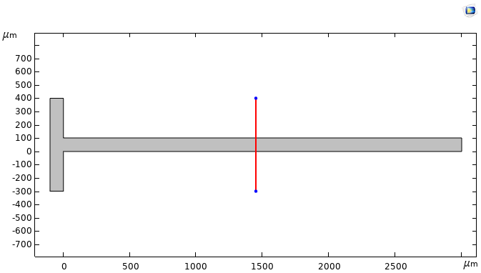

Hello, I am trying to simulate this geometry with comsol (laminar flow and transport of dilueted species ) I get the results of concentration, velocity and pressure ,but when I try to apply a cut line at the end of the geometry and 1D plot group and click on Plot ;the cut line coordinates change on its own ,like in this photo. I tried to simulate it with different versions(5.4 ,5.6 and 5.3a ) and I still have the same problem. Can anyone tell where is the probleme please

Maybe some Snap issue? Can you screenshot the cut line setup?

You could try the following. Go to results>datasets>cut line and define the cut line there. Once you have the cut line defined use the name of the cut line to draw the graph (e.g. Cut line 3D 1).
