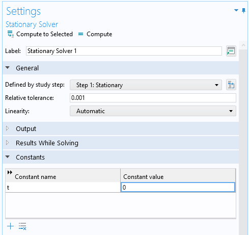

Hi Sean,
If you have an expression with "t" somewhere in your model and want to solve it using a stationary solver, you can then simply add a parameter or constant t and give it a value, such as 0. You can use a Parameters node, or you can define it as a constant in the Stationary Solver settings (see the attached screenshot).
Magnus
>Magnus, I'm not sure how to implement this. Can you post a sample .mph or a screenshot showing the setup? Hi Sean, If you have an expression with "t" somewhere in your model and want to solve it using a stationary solver, you can then simply add a parameter or constant `t` and give it a value, such as 0. You can use a **Parameters** node, or you can define it as a constant in the **Stationary Solver** settings (see the attached screenshot). Best regards, Magnus
