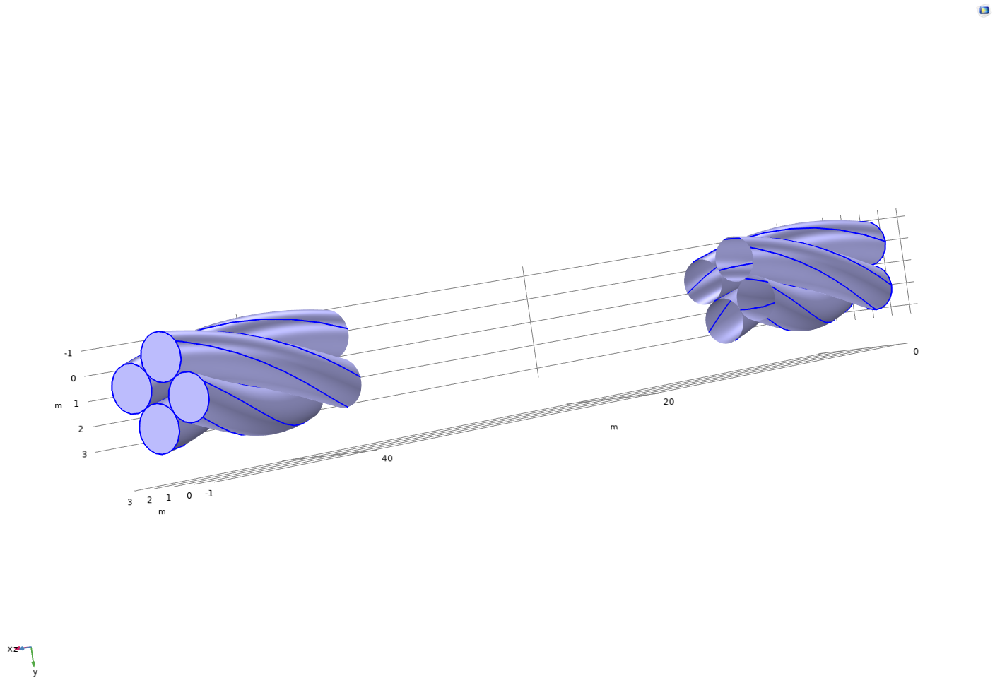

- The inteded information is not possible without the twist: I already have a model of simple straight wires (cylinders) representing the "Stranded Wire V1" geometry, but without the twist.
- It is cheerful to know that the corresponding 3D drawing is "straightforward". Attached it is my primal trying to build the geometry (a set of Helix wrapped around each others). It is a bad geometry containing areas overlapping, void spaced, tiny vertices, etc. For that I could not properly assign "Material" for the Helix (i.e., representing the filaments).
- Would be great if I can somehow send you the .mph file to be checked or to kindly explain what is concretely meant by "draw a cross section in a workplane and then sweep it along a helix".

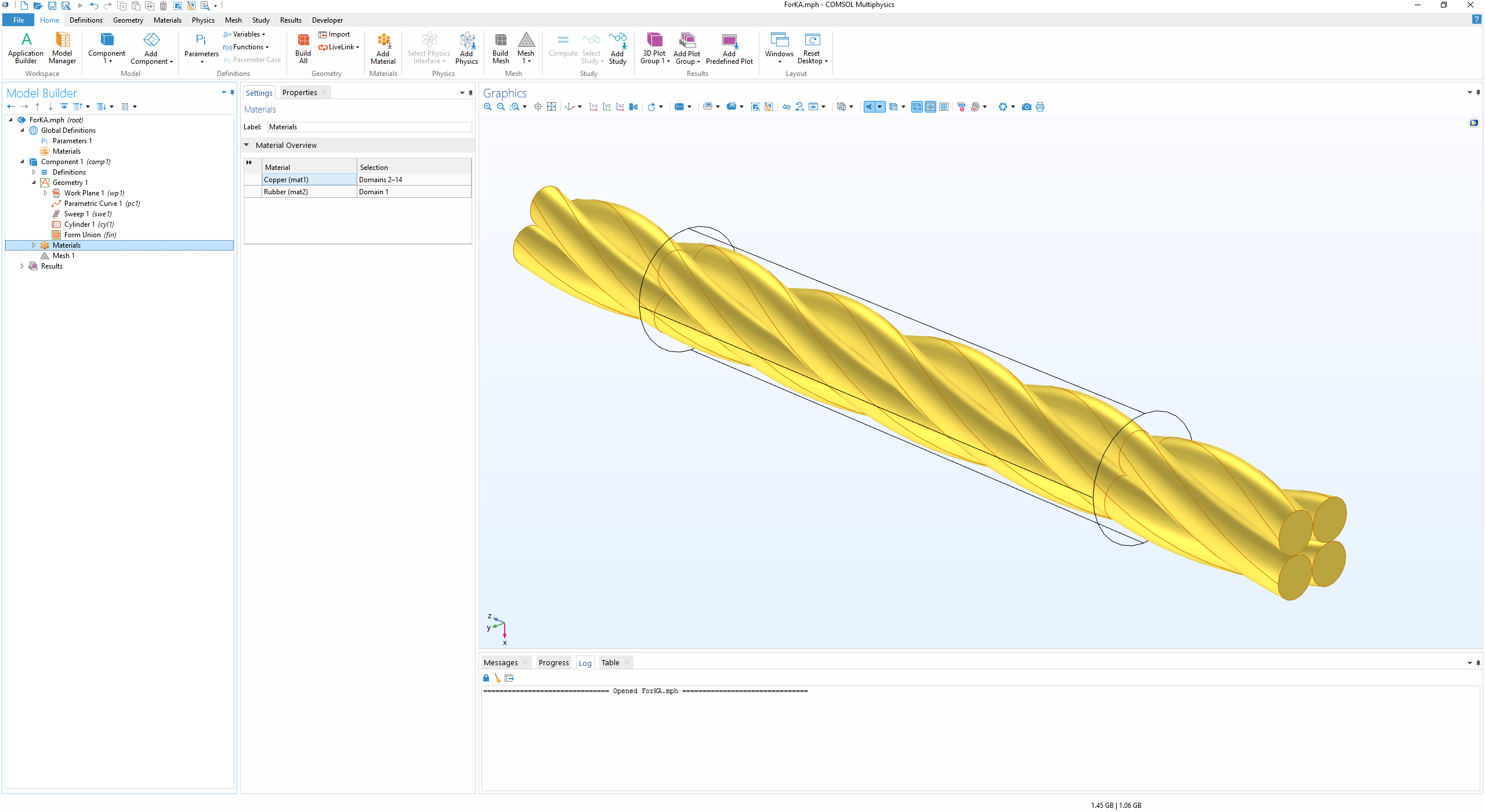

Here you go!
-------------------Jeff Hiller

Here you go!
Hi Jeff,
Thank you for providing a complete model.
Although the resulting geometry "looks" like the orginally attached Stranded Wire V1, but when tried to assign each of the filament to a Coil it turned out the the filaments exist actually only on the borders of the Rubber (cylinder). Please take a look at "geo".
With that model, we cannot proceed to any further study.
Khaled

Incorrect. The filaments exist throughout.

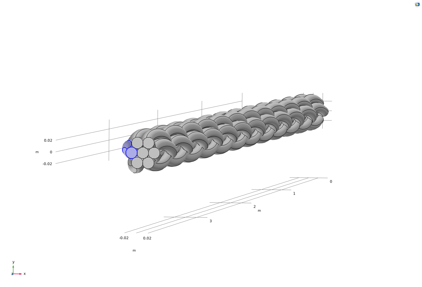

Hi Jeff,
Thank you. Kindly find below are my concerns,
- how to "scale down" the dimensions of the filaments? i.e., the diameter of each filament is to be of 5 mm instead of 1 m , having the length of 1 m.
- how to "add" more circles (i.e., primitives of the filaments before being "Swept" around the parametric curve) with respect to your rectangular array? For example, instead of 4 filaments, I wish to have 7 filaments, arranges in 3 rows: first upper row of 2 filaments, cenetered row of 3 filaments, bottom row of 2 filaments (as in Stranded Wire V1.jpg).
- in "ForKA.mph" - despite it is composed of only a 4-filament wire and we intend to make it a 7-filament instead with a scaled down geometry - you can clearly see a "gap" or in other terms a "hole" or "space" between the 4 filaments:
a. is it possible to adjust the parametric curve so that the 4-filaments are more closely twisted together without any void in between?
b. the logic in a. is to be also applied to the intended 7-filament design
- I have attached a 7-filament twisted geometry design (helped by a colleague of you from COMSOL) but with inappropriate dimensions (circle radius is of 1 m): when 1. and 2. are hard to establish, you can kindly use the attached .mph file in order to reply to those comments.
Thank you Khaled
