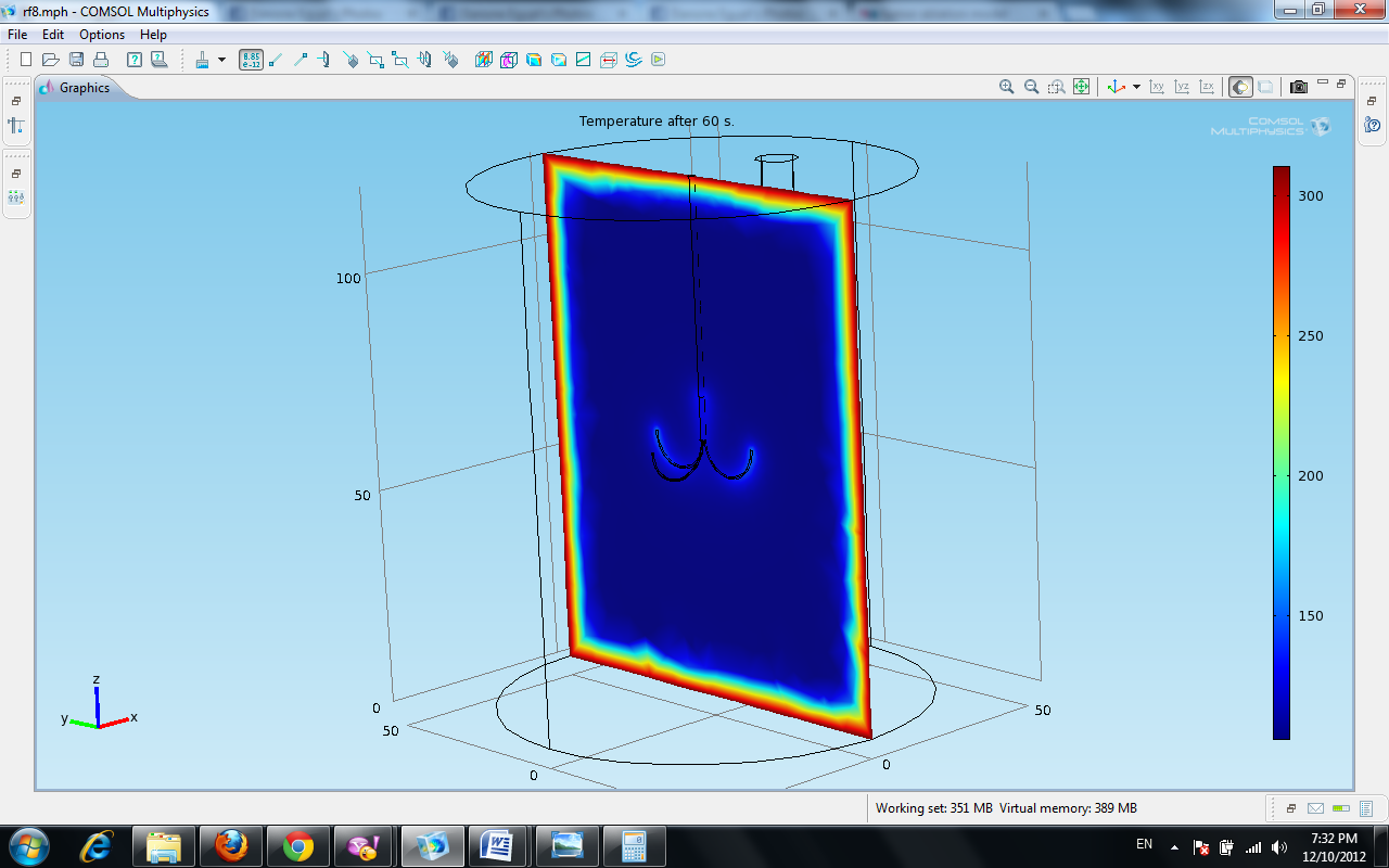

I did the steps as you told me, but the result of the temperature distribution were different from the case of the DC current, the photo of my result attached in this message and I also want to get the electric field distribution, please help me if you know what the problem in my model
thanks a lot
It is hard to tell what is wrong without seeing your model but seems that heat source is not defined properly. Make sure that setting for heat source is correct. I did quick run of the model with AC current source and results are quite close to the DC case. Let me know if you still have issues with your model and I upload AC version of mph file for you.

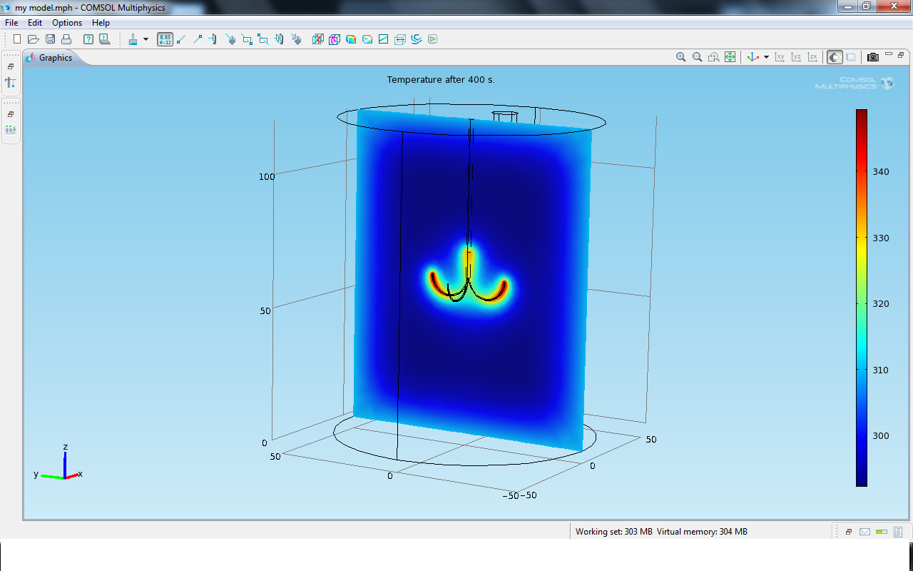

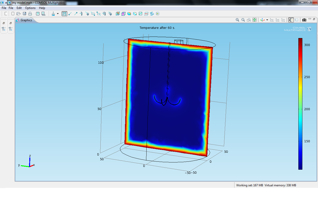

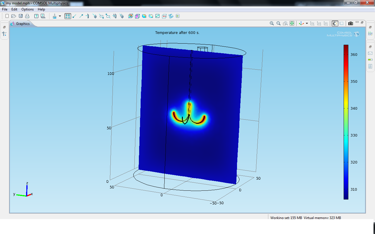

I reviewed my model again; I did the steps exactly as in comsol dynamic help and the steps you told me for AC current, I found that when the time in “3D plot Group” sitting is greater than 400 sec the result of temperature distribution become close to the DC case.
This is the link for downloading my model, because I couldn’t attach my model in this message: www.4shared.com/file/xl7rUuQC/my_model.html
In "3D plot Group 2" the temperature distribution at 60 sec and in "3D plot Group 3" the temperature distribution at 600 sec you can see the difference between the two results.please help me if you know what the problem in my model.
