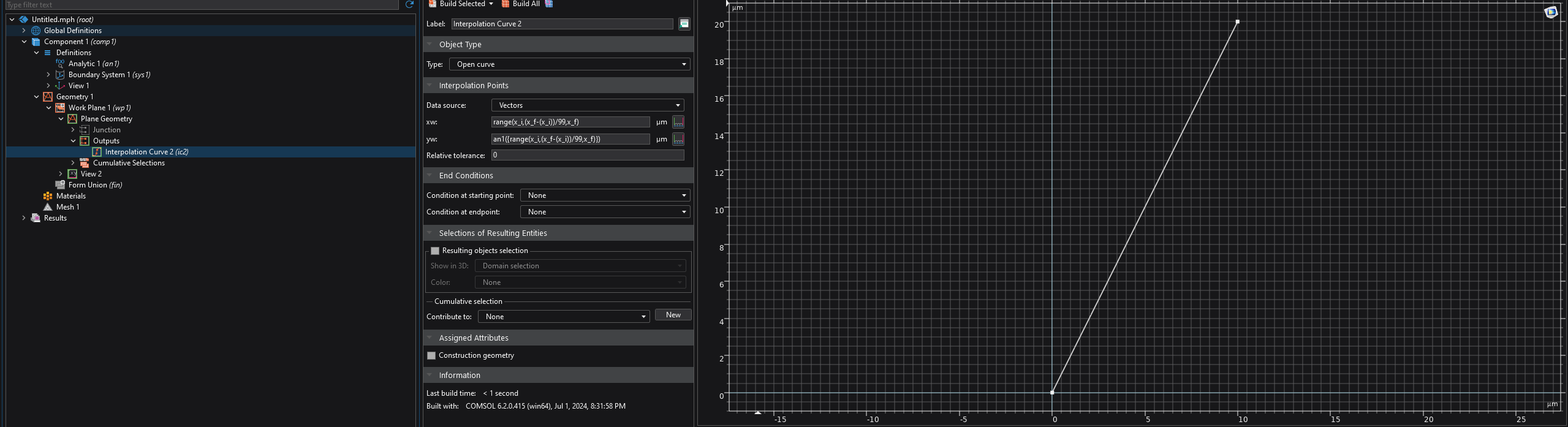

I want to create a 3D Interpolation Curve using an expression. For instance, let's use this simple example:
y=2*x
resulting coordinates would be:
x-y-z- 0;0;0 1;2;0 2;4;0 ...
I am trying to enter the expression "2x" in the "y" column (see image) but that returns a "x variable unknown" error. I obviously don't have the right approach.
Any suggestion?
Thanks, PL

Posted: 2 years ago 2024/07/01 12:41 GMT-5

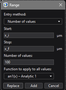

The doc on anlytic functions as well as interpolated curves is a bit thin. After making your analytic function, in Component-Definitions-Functions making sure to set the units appropriately, you could then call the function either by manually typing in an1(0), an1(1)... But I would guess that you want a smooth function. To achieve this, change the data source to vectors, and set a range for x, and then set (probably) the same range for y but this time choose the function at the bottom of the window. Hope the the screen captures help.
