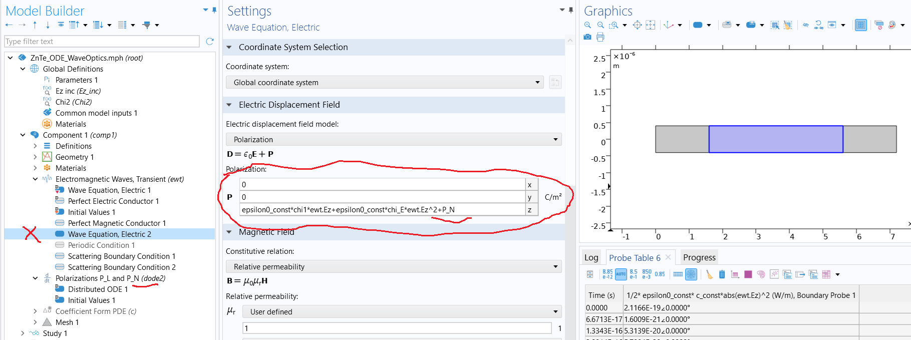

I'm working on similar topic. 1. You can analytically define the explicit expression of individual component of your polarizability (or external current density) in terms of the frequency domain solution of your input wave (ewfd.Ex, ewfd.Ey, ewfd.Ez). Eg. Px = chi2xxx(lda)ewfd.Exewfd.Exewfd.Ex + chi2xxy(lda)ewfd.Exewfd.Exewfd.Ey + ...
Here, the frequency dependence of your chi2 per matrix component is defined by separate function that takes the wavelength/frequency as argument. For simple comsol model, I think it is best to keep it non-dispersive. 2. Define two frequency domain solvers (pump, nonlinear response) 3. Add physics of Polarization (External Current Density) on your metamaterial and put your defined polarizaibility (or external density) in the definition. This way, the pump solver provides input for the nonlinear solver. 4. Run the two solvers and you get both linear the nonlinear response.

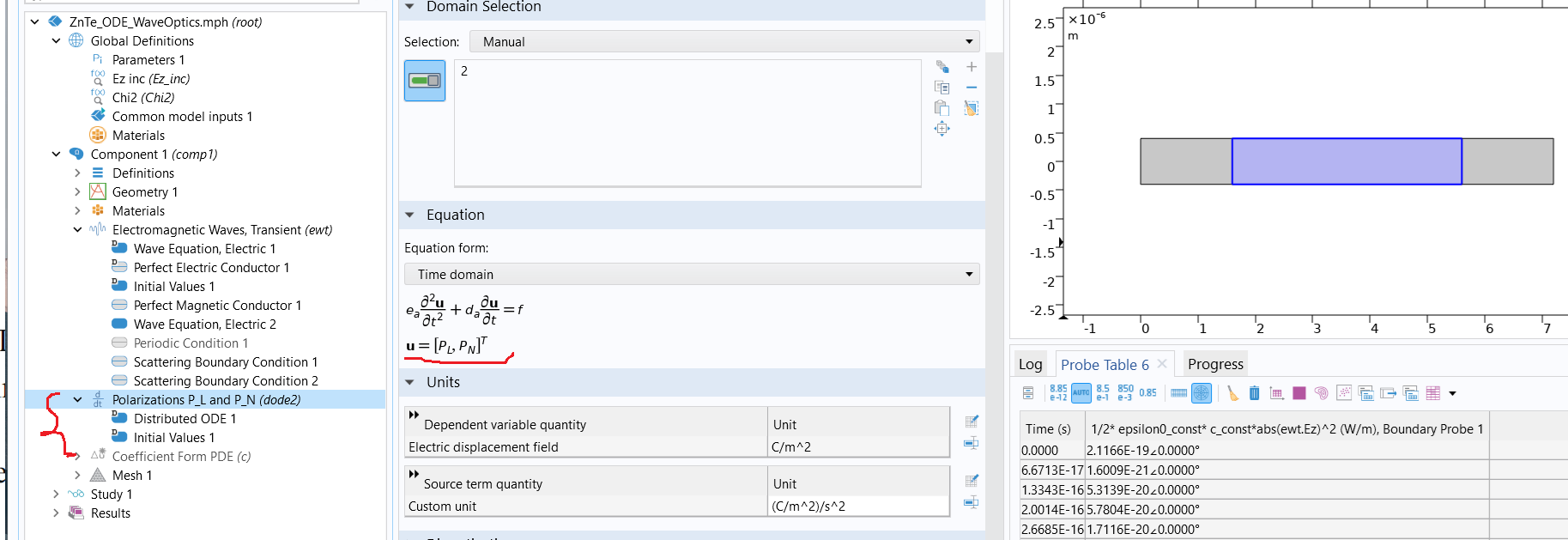

Attached are screenshots from our model to help you. Cheers!
Hi Ahmad, I'm working on similar topic. 1. You can analytically define the explicit expression of individual component of your polarizability (or external current density) in terms of the frequency domain solution of your input wave (ewfd.Ex, ewfd.Ey, ewfd.Ez). Eg. Px = chi2xxx(lda)*ewfd.Ex*ewfd.Ex*ewfd.Ex + chi2xxy(lda)*ewfd.Ex*ewfd.Ex*ewfd.Ey + ... Here, the frequency dependence of your chi2 per matrix component is defined by separate function that takes the wavelength/frequency as argument. For simple comsol model, I think it is best to keep it non-dispersive. 2. Define two frequency domain solvers (pump, nonlinear response) 3. Add physics of Polarization (External Current Density) on your metamaterial and put your defined polarizaibility (or external density) in the definition. This way, the pump solver provides input for the nonlinear solver. 4. Run the two solvers and you get both linear the nonlinear response. Attached are screenshots from our model to help you. Cheers!
