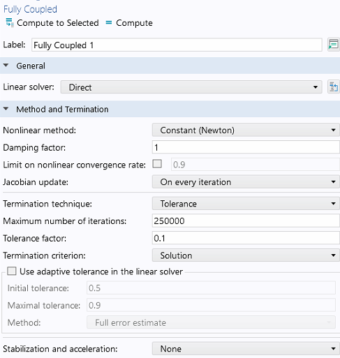

I use this method and I found loaded-spring-contact.mph (https://www.comsol.com/model/self-contact-of-a-loaded-spring-109781) for this simulation. However, currently I have issue with running. I'm running my contact simulation using time dependent study for two days and it has 4% convergence until I stopped that. For this case I'm using generalized alpha method with 0.75 alpha and I defined Nitsche contact. Mesh is refined and I'm using ramp load on my harmonic displacement. Without any contact the simulation runs for fair amount of time. I also used Penalty contact but got this error: - Feature: Time-Dependent Solver 1 (sol1/t1) Nonlinear solver did not converge. Time: 5.4253472222222225e-09 s. No convergence, even when using the minimum damping factor. Last time step is not converged. I noticed that even with increasing the number of iterations I cannot help with convergence. Once I apply the contact it cannot converge. Do you have suggestion how can I improve convergence in contact problem?
Thank you very much I use this method and I found loaded-spring-contact.mph (https://www.comsol.com/model/self-contact-of-a-loaded-spring-109781) for this simulation. However, currently I have issue with running. I'm running my contact simulation using time dependent study for two days and it has 4% convergence until I stopped that. For this case I'm using generalized alpha method with 0.75 alpha and I defined Nitsche contact. Mesh is refined and I'm using ramp load on my harmonic displacement. Without any contact the simulation runs for fair amount of time. I also used Penalty contact but got this error: - Feature: Time-Dependent Solver 1 (sol1/t1) Nonlinear solver did not converge. Time: 5.4253472222222225e-09 s. No convergence, even when using the minimum damping factor. Last time step is not converged. I noticed that even with increasing the number of iterations I cannot help with convergence. Once I apply the contact it cannot converge. Do you have suggestion how can I improve convergence in contact problem?
