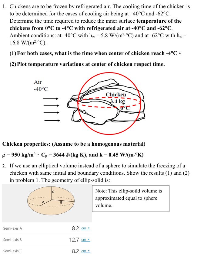

Hello everyone. Does anyone have a COMSOL multiphysics file that is a solution to the 2 problems on the picture attached. It can also be a PDF file that has the steps on solving this problems. Please share the files you have them or any information that might be helpful. This is part of my exam, and it is due on Monday. So, I would really appreciate your help. If you have something that might be helpful, please share it here or on my email. fashkhabako18@gmail.com

This problem seems to be laminar flow plus heat transfer. There should be several related examples at https://www.comsol.com/support/learning-center.
One question is whether the heat of fusion (phase change) is to be included, if so it becomes a bit more complicated.
This brings to mind the joke about the physics Ph.D. who was hired by a dairy. I believe an ellipsoid approximates a chicken better than a sphere approximates a cow.
This problem seems to be laminar flow plus heat transfer. There should be several related examples at https://www.comsol.com/support/learning-center. One question is whether the heat of fusion (phase change) is to be included, if so it becomes a bit more complicated. This brings to mind the joke about the physics Ph.D. who was hired by a dairy. I believe an ellipsoid approximates a chicken better than a sphere approximates a cow.
