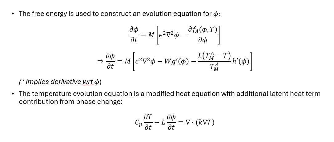

I have been trying to simulation a phase field equation coupled with temperature which are essentially two heat equation (parabolic) form with coupling in the form of having their respective variables in the other physics. I have used Weak Form for both the equations on COMSOL 6.2 and tried automatic mesh refinement to make the mesh finer around the interface as the interface grows in a time dependent study.
Unfortunately, there seems to be not much of detailed blogs here explaining the mesh refinement module and where to apply its respective options. I am not sure how i am getting the result I am or how to troubleshoot it. I have attached the mph filed for reference and also the equations I am using to simulate. Any help is highly appreciated.
