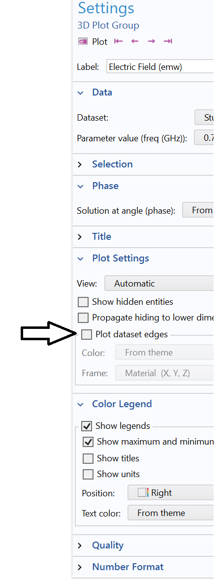

I want to hide some edges in the geometry for the visualization purposes to plot the contour plots.
In model builder in the definition section under the view option , there is option for 'hide for geometry' but there is no option for 'hide for physics'.
How can I enable this option for better contour plots in post processing without intermittent lines/edges ?

To hide edges in post-processing, consider unchecking the "Plot dataset edges" checkbox under Plot Settings in the Settings panel associated with your plot. For example, see the snapshot attached.
Posted: 9 months ago 2025/12/28 1:05 GMT-5
Thanks Robert for the reply, it works well.
