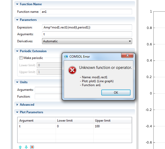

Ok, so I defined the parameters, Amp and period1 in the parameters menu. When I try to plot the an1, it gives me an error "unknown function or operator" mod1.rect1.
I attached a picture of the error if you want to take a look.
Thanks again for helping!
Ok, so I defined the parameters, Amp and period1 in the parameters menu. When I try to plot the an1, it gives me an error "unknown function or operator" mod1.rect1. I attached a picture of the error if you want to take a look. Thanks again for helping!
Posted: 1 decade ago 2013/06/25 1:08 JST
Sorry, that is because I had an rectangle function that was named rect1 in my model 1 (mod1), if you dont have a rectangle function you can loose that term.
Hope that it will work now.
Barend
Sorry, that is because I had an rectangle function that was named rect1 in my model 1 (mod1), if you dont have a rectangle function you can loose that term. Hope that it will work now. -- Barend
