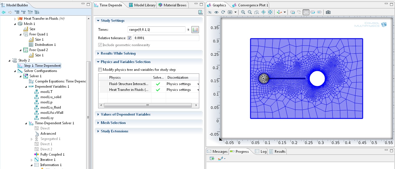

Dear All,
My model is 2D vibrating plate at air that blow air to a hot cylinder, I used Fluid-structure interaction to model the vibrating plate and air domain, notice that there isn't ant inflow and air must move just because of plate's vibration, for heat transfer on cylinder surface, I used heat transfer in fluids physics.
For plate, I used a cantilever beam and put point load as wv1(t), I used sine function for wv1 already.
When I run my model, it takes so much time and finally gives error that it doesn't converge.
I changed my mesh and small time interval to get the result faster, but didn't solve the problem.
Would you please help me to solve this problem?
