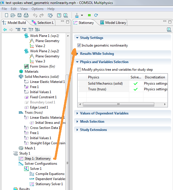

As trusses can only sustain axial forces, it is needed to enable the checkbox "geometric nonlinearity" in the study.
This will take the extra stress of the truss into account when there is a small rotation in the wheel. Thus resulting in the minimal stress state when there is no rotation.
Attached you can find the model.
Note that the "include geometric nonlinearity" checkbox can be found in step 1 under study 1.
Frank
