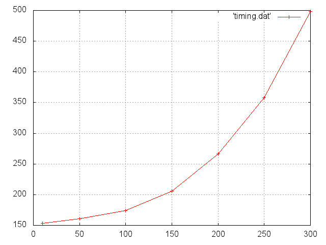

I have created a simulation suite that calculates the electrostatic field of a given device and traces particles through this field. Since none of the available particle release nodes suited my needs (I wanted to generate particles in the (x,dx/dz) and (y,dy/dz) 2-dimensional phase spaces according to a gaussian distribution described by the Twiss-parameters), I followed the suggestion of the COMSOL experts and generated a ReleaseFromGrid node for each individual particle, where I could set the particle coordinates explicitely. It runs fine, but as I increase the number of particles, the simulation time seems to show an exponential increase (see attached file, simulation time [s] vs. number of particles). This would become prohibitively slow very quickly.
The physical and virtual memory usage of the simulation process was not significantly different among the studied cases (around 1+1 GB). My notebook has 4 GB memory and a Core-i7 processor.
As far as I know inter-particle interactions are not taken into account in COMSOL by default, so I would naively expect a roughly linear behaviour (with an offset corresponding to the electrostatics calculation which is independent of the number of particles). I have COMSOL 4.3b
