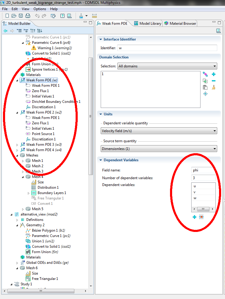

"But the coefficient form PED is overriden, I can‘t add another coefficient form PDE."
If you have two dependent variables then you can define two PDEs.
- Either add the PDE module two times when you select the physics. (which seems the best in your case as J and phi are different units/fields)
- Or define two dependent variables in a single PDE physics node.
There are several points where you can make these two options happen. Either during the first screens when setting up the physics or later by adding or editing the physics.
See also attached image with an example of multiple added physics nodes and multiple defined dependent variables.
