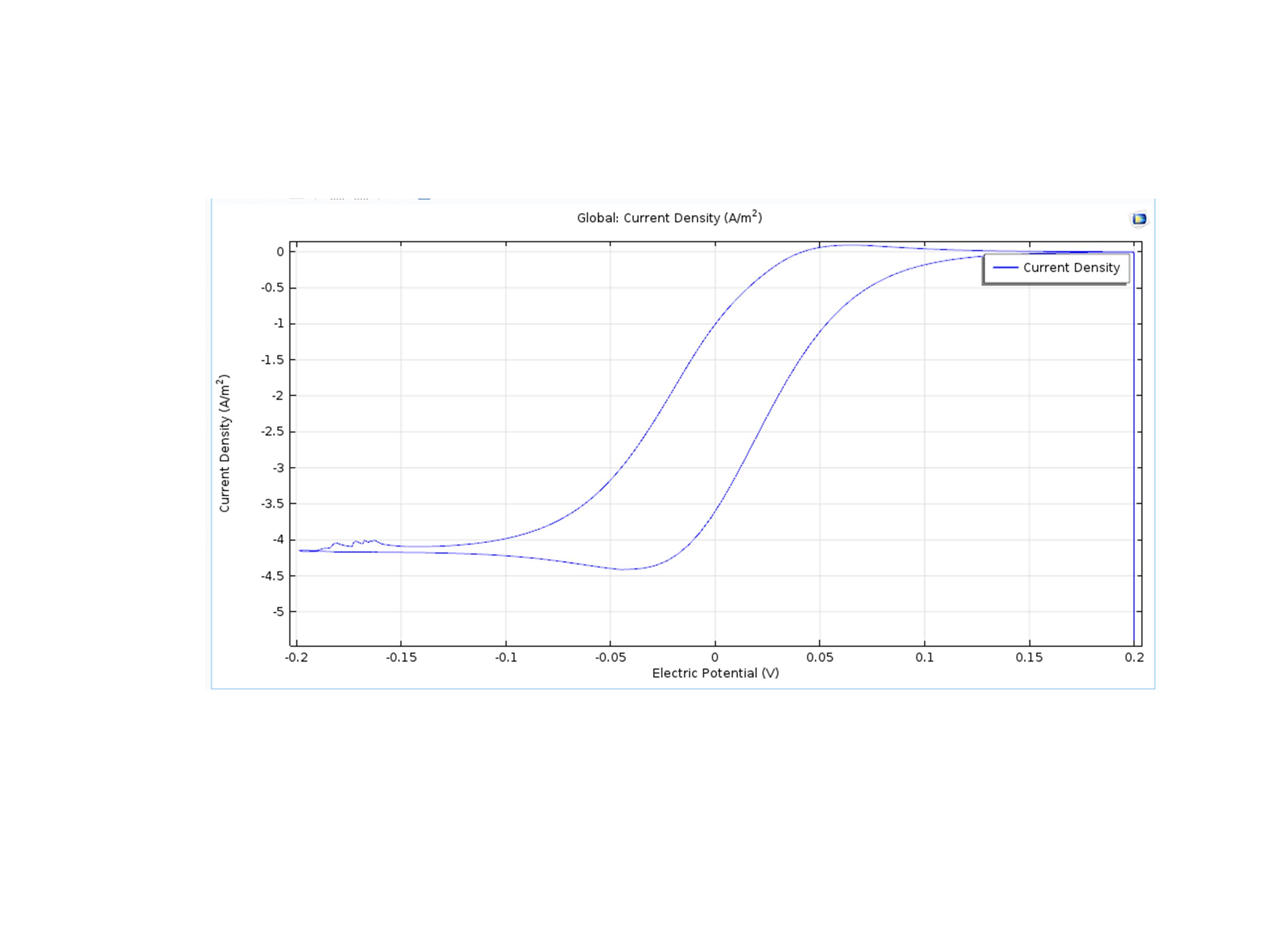

Posted:
1 decade ago
2015/06/25 14:17 GMT-4
I got some result but limiting current is not what I expect to get.
I choose automatic meshing here in this results.

Posted:
1 decade ago
2015/07/02 14:51 GMT-4
Try this (attached). I updated to version 5.1.
The idea of meshing is that close to the electrode very dense mesh is needed to reach better accuracy in current calculation. Swept mesh with distribution highlights the fact that the flow profile is parabolic and close to the boundaries changes are the largest. In y direction the mesh does not need to be very dense, except close to the electrode.
br
Lasse
br
Lasse
