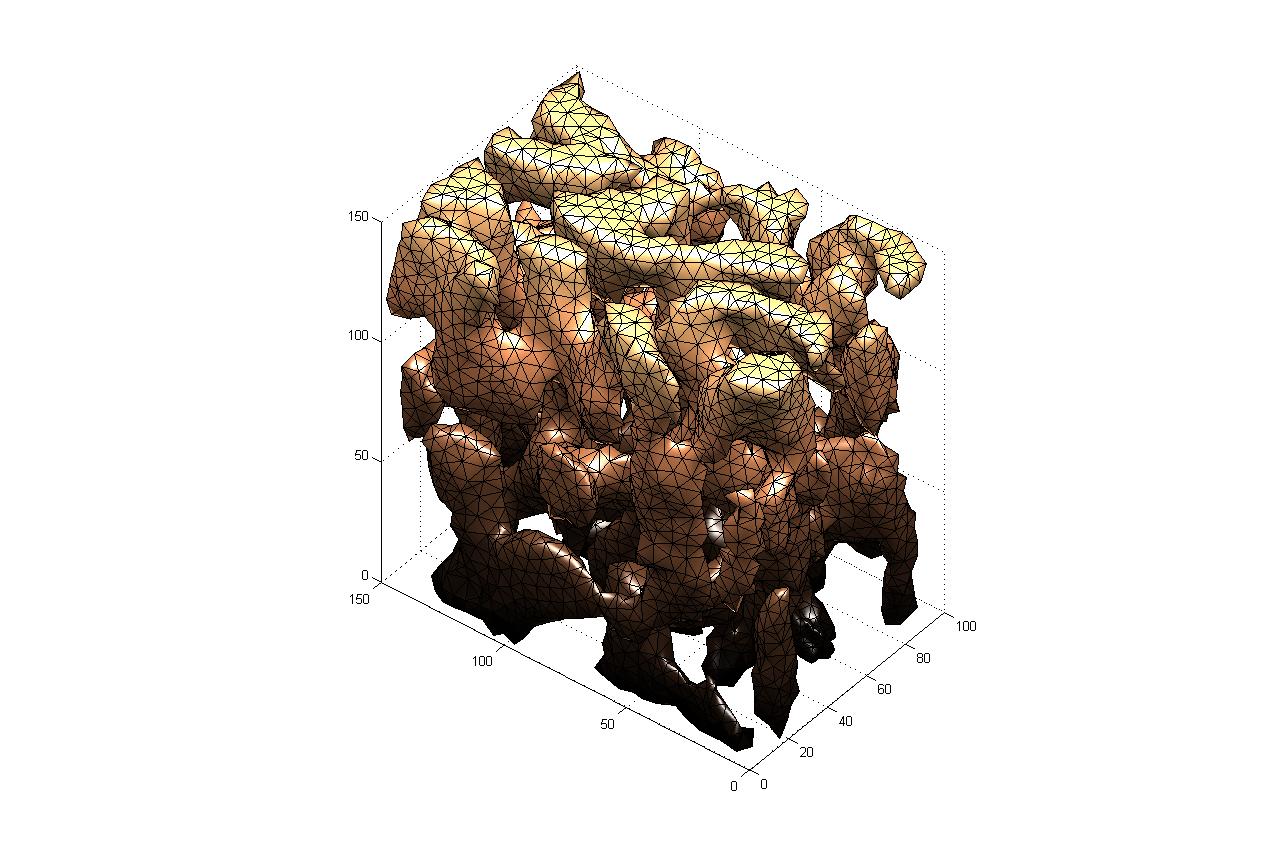

The problem at hand is to model a complicated geometry like the one attached with this message. It has been generated from tomographic anaysis and I have meshed it in MATLAB. I used the MATLAB to export the elements and coordinate to export into fem.mesh, following the commands in the documentation. But now I cannot precisely select only the top and bottom surface nodes using "box" tool; it always selects some more nodes from other planes below. So I started to wonder if I can define a group of a boundary node set (for example like in ABAQUS), then BC application will be precisely imposed on the desired nodes. However, I could not find how to define a node set in the MATLAB. I figured out how to create a new group in "fem.bnd.constrant and fem.bdn.ind". The problem remains to how to associate some nodes to this new group. The fem.mesh object is not accessible in matlab workspace so I cannot see/over ride the values.
