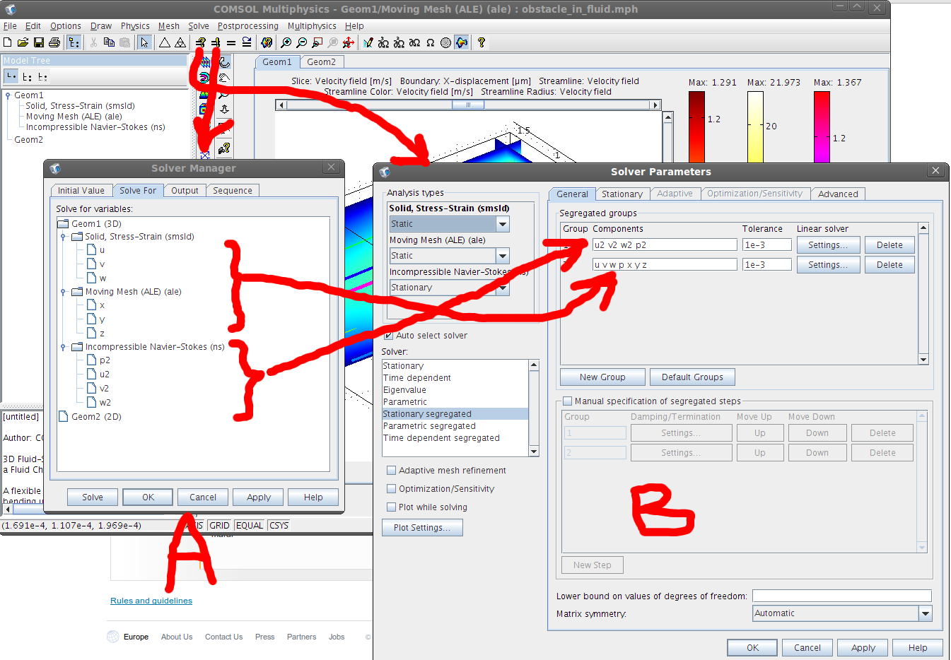

Look at the A window. Every variable there is listed in the B window. Don't miss any of them. You may see some lm3, lm4, ... when you enable the weak formulation. You should add them as well to the B side.
[QUOTE] salam Im very thankful for your discription.. Danial Im using version 3.5.Would you please tell me how to make changes to remove that error? Its your kindness. maral [/QUOTE] Look at the A window. Every variable there is listed in the B window. Don't miss any of them. You may see some lm3, lm4, ... when you enable the weak formulation. You should add them as well to the B side.

THANK YOU VERY VERY MUCH DANIAL...you are so cool...
