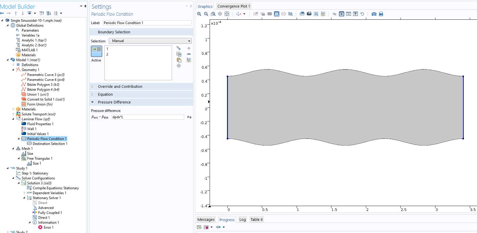

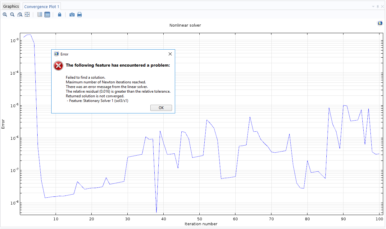

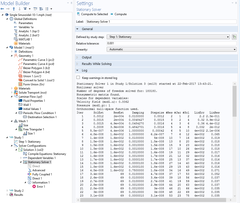

Thank you so much for the answering. I attach three pictures which you can have a closer look at the problem I am encountering. Picture 1 shows the model and periodic flow boundary, and Picture 2 shows the Solver Configuration where you can see, I just adopt the default settings and the relative tolerance is 0.001. Picture 3 shows the Converge plot, as you can see the Error is really tiny. But I do not know why the calculation is not stopped when the Error is below 0.001.
