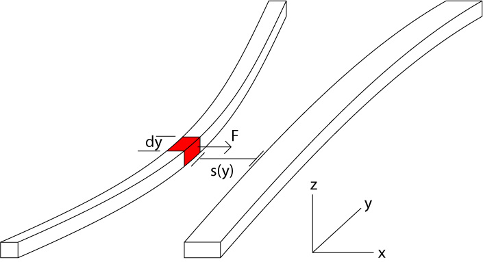

I have 2 beams, and I have the force that depends on the distance between the 2 beams (I have the formula for the force). And if the beam is deformed (not straight), the force on the section between y and y+dy is given by the distance between the beam at that y. (Please see the attached picture for this.)
So my problem is, how can I specify this force in Comsol? Or specifically, how can I find the expression for point-by-point distance so I can use that expression in my force formula. I guess I can define like 100 pairs of points along the two beams and specify the force on each point manually, but I believe there should be an easier way to do this. Maybe something to do with pairs but I don't know.

before discusssing "how to in Comsol" you should perhaps think more over your model. Are you attempting a simple physics approach and want to add spme specific force functions yourself, or are you thinking of doing a "multiphysics" simulation, where the force is driven anoher "physics" than the structural ones (i.e. electrostatic, magnetic ...) ?
And second question, I find it difficult to believe you force i only due to the nearest point between the two bars, isnt it rather that for all dy the force is the integration of normal force component over the full length of the other beam ? (use the integration coupling variables)
If you want to do it in the multiphyics approach, you need to add the second physics, define the model parameters and then solve either both together or "together segregated" to improve convergence or computing time to solve
If you want to stay in one physics (structural) then you need to define a force as a function of an integration coupling variable, and get the vector components while using the local normal and tangential vectors
Both are in my mind perfectly valuable ways, it all dependes on your desire and how you define your model.
Main suggestion: start simple with one physics at a time and then only couple them, but this might well be what you are attempting anyhow ;)

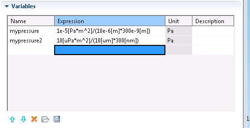

Now Comsol cannot always understand what we want so it might end up with funny units requeirng some handcalculation to check if correct. You can help COMSOL to choose your units by slightly modifying the one we use, such as for "mypressure" see image:
1[N]/(1[m]*2[m]) => 0.5[N*m/m^3]
while
1[Pa*m^2]/(1[m]*2[m]) => 0.5[Pa]
Then when using the / division operator with values & units, use enough brackets () as the units tend to be forgotten and the result is not always as expected (was required in V3.5, somewhat less important in V4)
