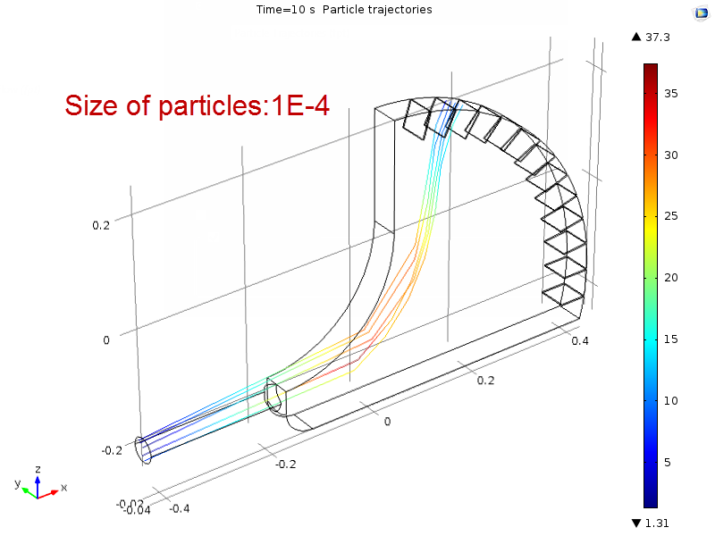

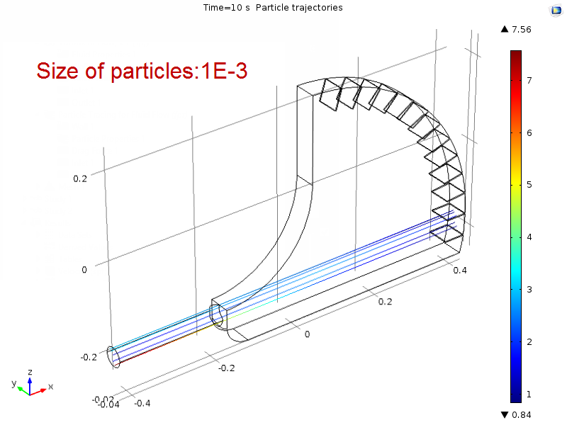

I already have the flow simulation, but when I try to add particle tracing for fluid flow, the particles go straight and don’t follow the flow.
The data that I’m using is here:
-Material: Air (built in)

The problem comes with bigger particles. When I use a particle with a diameter lower than 1E-4; it simulates the particle being dragged by the flow. If I use something greater than that; they all go straight.
Do you know if I can simulate bigger particles? i.e. 5mm, 3mm etc.
