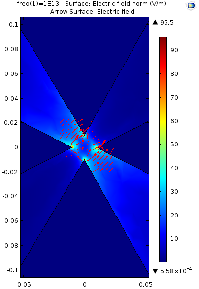

I have e-field distribution (attached fig.1) for a defined antenna structure at a certain frequency. I would like to plot the time-dependent e-field distribution (E-field Vs Time) along a certain line of the structure. In this case, I am expecting the time-dependent e-field distribution to be non-sinusoidal in nature.
Can you please suggest me how can I plot E field Vs time along a specific line in the antenna structure from the E-field distribution that I have obtained from frequency domain in frequency (attached fig.1).

Your picture doesn't explain much.
First of all, there is no time in a frequency domain study. If you have a frequency sweep you can do an FFT to transform it to time domain.
It is completely unclear how a line plot would correspond to a time domain plot. The line plot gives a spatial distribution of the E-field.
You can display a phase plot for any point or global quantity of the model. But this will always be a harmonic curve of the study frequency.

The figure that I have attached here shows the e-field distribution at a particular frequency (10 THz in this case). However, a parametric sweep can be performed for higher frequencies as well. I was wondering if I can perform 'Frequency to Time FFT' study to obtain the time-dependent e-field distribution.
The thing that I actually want to do is - to obtain the voltage that is generated between the two antennas. The information that I got till now is the e-field distribution in frequency domain. In order to obtain the generated voltage, I want to integrate the time-dependent e-field distribution (non-sinusoidal in nature) along a path (dl), basically integral of E.dl which will give me Voltage generated along that path of the structure. I hope, I made it clear to you.
Would you please let me know, how I can perform 'Frequency to Time FFT' study after frequency sweep ? Please kindly let me know. Thanks a lot !

the FFT procedures are explained in the COMSOL documentation and I would suggest to explore the application library.
For a line integral of the E-field you probably don't need to transform to time domain.
