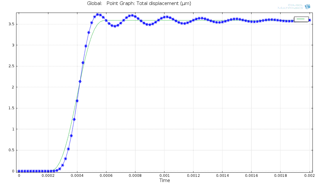

I'm investigating an FSI problem.
I'm interested in the frequency response of a membrane of a reservoir with water but I have found that a frequency analysis with FSI can be a bit tricky.
Instead, I have done a pulse response of the membrane. By applying a force pulse using a smoothed step function on the top of the membrane. I then decrease the time steps and smoothness of the pulse to find the point at which the membrane will 'ring'. From this ringing, I can deduce the first resonant frequency.
The ringing can be seen by plotting the centre deflection (fsi.disp) as a function of time. I've included this plot, as a reference, the applied step function is plotted as well, (scaled so you can compare it).
