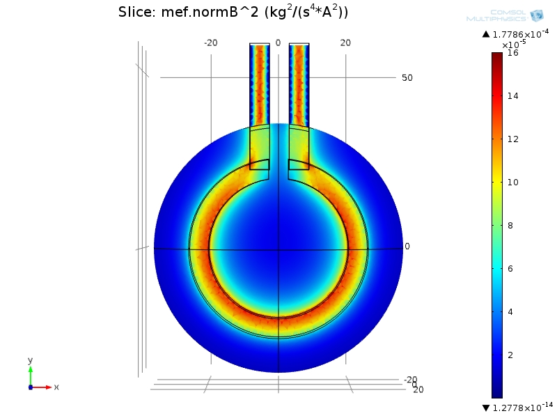

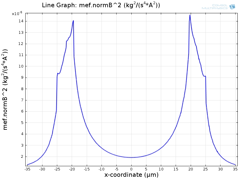

I am a new user to COMSOL, and I have been trying to model a wire loop made of copper with current running through it. I have to wires that make a small loop and I was hoping (and expected) to see the magnitude of the B-Field greatest in the center of the loop. However, what COMSOL shows is a B-Field greatest at the wire. Unfortunately as well, when I try to plot a graph of the field across the wire loop I am unable to get a smooth graph (picture attached), which means I can't take the gradient of the field to try and calculate the force.
I have tried both 2D and 3D models. The 3D model is too intensive for my computer, taking in excess of an hour to run (using a very fine mesh to produce a smoother curve), and then frequently requiring a restart of the computer afterwords. I would like to do 2 things, first I would like my model to show a result of B^2 (magnetic pressure), preferably with the maximum B-Field in the middle of the loop (unless of course someone knows some physical reason why it wouldn't be), and I would like my model to produce a smooth curve when I take a "slice" of the data across the x-axis without the sharp peaks.

3. Jpeg of results of 3D model, for norm of the B field squared
4. Jpeg of graph produced from taking "slice" of data across the x-axis showing the two "sharp" points

FG
